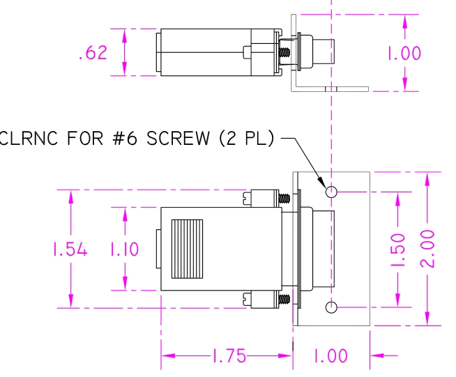

Bob,
My comment was about 'buttonology'; not building. I've got a little clock that's RF linked  to Federal time broadcasts. It's totally impossible to use any of the elaborate built-in functions with out the manual, because it has two or three unmarked buttons, and to access the various functions, you need to know the "combination". No one can use the thing without the book in front of them. Same thing for most kilo-function watches, etc. Even my old Icom A-4 handheld comm is like that. I seldom use it, so even though I've owned it for over 20 years, I still don't know how to program frequencies into it. If it had a keypad, anyone could pick it up and enter '122.75', or '125.25', etc. But since it doesn't, the unwashed can only hold the up or down button until they see the freq they want. For me, a perfect example of something simplified to the point of un-usability.
Charlie
Virus-free. www.avast.com [url=#DAB4FAD8-2DD7-40BB-A1B8-4E2AA1F9FDF2][/url]
On Sun, Oct 15, 2017 at 10:22 AM, Robert L. Nuckolls, III <nuckolls.bob(at)aeroelectric.com (nuckolls.bob(at)aeroelectric.com)> wrote:
At 07:30 AM 10/15/2017, you wrote:
That stuff is cool as far as programming tricks go, but who will be able to use the hardware except the original designer? I, and everyone else on this list, have owned dozens of electronic gadgets over the years that are absolutely impossible to set up and use without the English-as-a-second-language printed manual that you can't find after the 1st month of ownership. I have to use google on my desktop to explore how to get my phone apps to work like I want.
  This is amongst the simplest PIC applications we'll
  ever encounter . . . once the first installation
  has combed out the nits . . . it seems unlikely
  that there would be many if any software upgrades.
  Another consideration is flexibility. Suppose the
  prospective end user wants only two cameras . . . or
  three?  Different software . . . or strapped selection
  on the ECB?
  Then there's a matter of packaging. One can easily
  spend more time putting a gizmo in a box and installing
  it than it took to build the gizmo. Certainly, packaging
  issues are a major component of a development project.
  A possibility for this project is to package in a
  D-sub housing. The enclosure is an off-the-shelf, inexpensive
  product that simply snaps onto the final assembly.
  An ECB can be soldered directly into the gap between
  rows of solder-cups on a dsub.
[img]cid:.0[/img]
  and dropped into a plastic housing that simply
  snaps together.  A product housed in a 15 pin
  back shell has these dimensions.
[img]cid:.1[/img]
  This project can probably be fitted into a
  25 pin back shell.  I perceive no particular
  advantage in taking power and signals on/off
  the board on RCA jacks . . . shielded
  wires are just as easily dropped onto d-sub
  pins. RCA plugs are not the most installer
  friendly connectors.
  With the extra pins, the user could intall
  jumpers on the connector to select 2, 3 or 4
  cameras.  Other jumpers might select 3, 4 or
  5 seconds per step . . . etc.

5. Bob made some suggestions:
    A. Use a 10-turn potentiometer. I have a 1-turn cermet trimmer in the BoM right now ($0.79), but it's easily changed to a 10 or 20-turn ($1.43), or to pads for a remote pot ($0.76) if desired.
    B. Design for a D-25 backshell. Good idea, but will the video signals suffer on a shielded wire -vs- an RCA cable? If not, let's do it. These NorComp parts are the only ones I can find whose datasheet includes inside dimensions...
    https://www.norcomp.net/rohspdfs/BackShells/InternalDimensions/ID-983Series.pdf
    ...and it doesn't look like I can fit everything into the space in a D-25 shell. The D-37 shell should have room to spare. Bob, if you have a deep D-25, could you give me the part number?
    C. Use excess pins in the D-Sub as selection jumpers for number of cameras, scan rate, etc. I presume this would require a PIC pin to read each jumper. Or perhaps you could use a resistor ladder across multiple D-Sub pins and read the ladder voltage with a single PIC pin to determine which jumper is installed. Very good idea for setting number of camera inputs, but I don't see the point for scan rate; a trimmer (or rotary encoder) seems fine.
    D. Use ExpressPCB. I haven't used them for at least 20 years. I don't like their "walled garden" model or their prices. Their closed software is the antithesis of "open source," and I'm never in a big enough hurry to justify the expense. My work will produce standard Gerber files that any board fab can use. Anyone can order 3 copies of the board from OSH Park...
    http://www.oshpark.com/
    ...for $5/sq inch with free shipping, or upload to any of a half dozen Chinese fabs...
    http://www.pcbshopper.com/
    ...to get 10 copies of the board in 2-3 weeks for <$20.
    E. Provide "kits" of a PCB and programmed PIC. Sounds like a fine idea to me, if a PIC is the way we go.
6. Paul has a first draft of PIC software running, and Alec has volunteered to write code as well. It sounds like we're in good shape WRT wrangling ones and zeros.
More to follow...

Wade,
We haven't heard from you for awhile. Since you're likely to be the guinea pig on this project, there are a few items you should have input on:
    - Do you have a preference WRT discrete ICs -vs- a PIC microcontroller?
    - Do you have any desires for additional features or functions that would push us in one direction or the other?
    - Of the user interface options you've seen discussed, what would be your preference?
    - For camera scan rate, would you prefer to set it once and forget it, or have an accessible control for routine use?
    - Would you prefer to install a device with five RCA jacks for signal and a 2-position header for power, or one D-Sub connector for everything?
Clayton, you expressed interest in getting one of these also; feel free to offer your opinion on these questions too.
