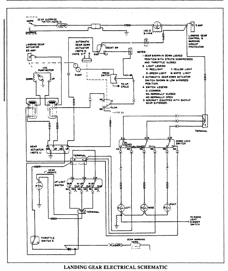

Below is the landing gear circuit, I need a device or build one that can use the 12volts coming from the gear down and locked switches and only send 12 volts to another device[for testing a led] IF ALL 3 lights (gear down and locked)

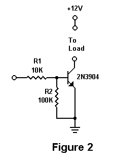

I thought use 3 NPN transistors in series but it seems on my test, if I supply 12 volts to the base of the npn it still lights the led (leak though ?) with no voltage on anything else
I am using figure two of these examples
http://www.rason.org/Projects/transwit/transwit.htm
IDEAS ?
