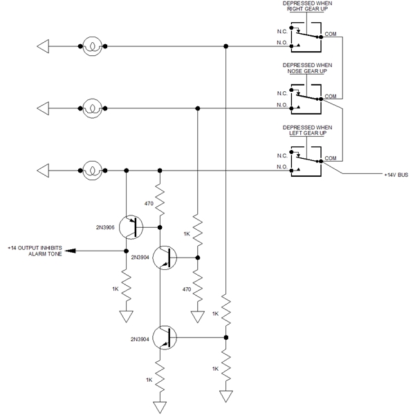

Need a device to send 12volts when all 3 green lights
PostPosted: Fri Jan 12, 2018 11:30 am    Post subject: Need a device to send 12volts when all 3 green lights Reply with quote
At 05:03 PM 1/11/2018, you wrote:
Then I would lose each gear indication. This is for an audio alert device input if the gear is not down and locked (all 3)
From: owner-aeroelectric-list-server(at)matronics.com [ mailto:owner-aeroelectric-list-server(at)matronics.com (owner-aeroelectric-list-server(at)matronics.com)] On Behalf Of Robert L. Nuckolls, III
Sent: Thursday, January 11, 2018 3:04 PM
Subject: Re: Need a device to send 12volts when all 3 green lights are light
Okay, how about something like this:
[img]cid:7.1.0.9.0.20180112132936.0675e9e0(at)aeroelectric.com.0[/img]
