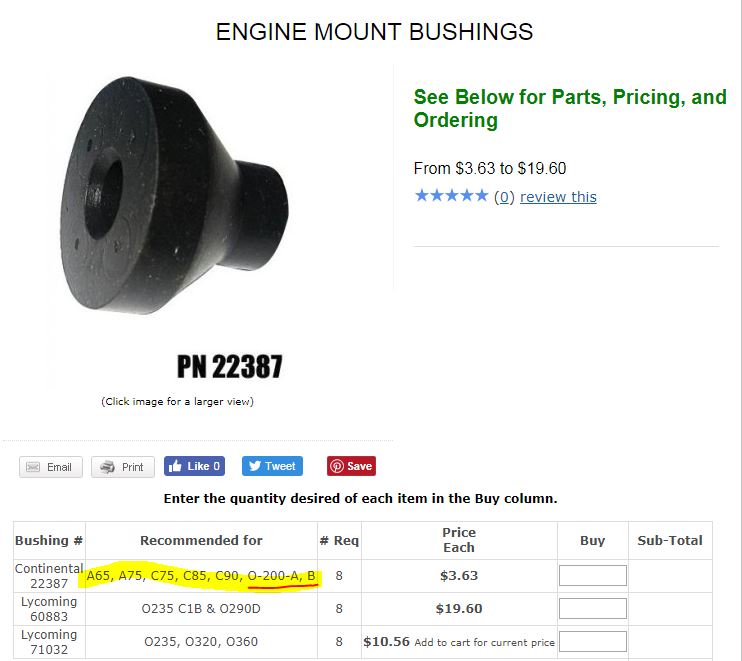

I know the rubbers are a different style on the 0-200. They have a sleeve bushing that runs thru the rubbers and i think cupped washers. I do believe the mount points are the same dimensions as far as the engine mount goes.

PostPosted: Tue Feb 06, 2018 8:33 am    Post subject: Re: piet Reply with quote
Aircraft Spruce lists the same part number for all of these engines...

One of the reasons I went with a C-85 was that I measured the mount profile at the accessory case and found it was exactly the same as an 0-200. If I choose to upgrade to 100 Hp I could always just change out the engine with little to no fuss with the cowl and mount.
Of course, don’t trust my measuring, do your own research here.

When I changed the engine on my old Cessna 140 from a C85 to an O-200, I had
to install a new mount.
Jack Phillips
Smith Mountain Lake, Virginia
- The Matronics Pietenpol-List Email Forum -
http://www.matronics.com/Navigator?Pietenpol-List
jboatri(at)emory.edu
PostPosted: Tue Feb 06, 2018 12:31 pm    Post subject: piet Reply with quote
Hm. When we exchanged the A-65 for a C-85, the same mount worked.

steven.d.dortch(at)gmail.
PostPosted: Tue Feb 06, 2018 1:15 pm    Post subject: piet Reply with quote
65 to 85 are the same case by in large. There was some change from teh 85 to the C90 and O200. I cant remember which one that is Not a great (still good) the 85 or 90.

Steve; the change in the small Continentals came when the A series went to the C series. The A series engines are all 171 cu.in. (bore 3.875", stroke 3.625") and got different horsepower ratings from 50 to 80 depending on compression ratio and RPM, plus other tweaks here and there. The A80 is the slug of the bunch and is not often seen, the pistons having 5 rings vs 3 on the smaller siblings, so those have higher friction drag and a higher parts count. The A80 puts out its rated power at 2700 RPM, so coupled with more rings on each piston and heavier pistons, they develop more heat and friction at rated output. By contrast the C85 puts out its rated power at a much more modest 2575 RPM, so in this power range the C75 and C85 are much favored over the A80.
The early C series, the 75 and 85, are 188 cu.in. displacement by virtue of the bore increasing to 4.0625" over the A series engines.
The later C series, the C90 and O200, also have the 4.0625" bore but the stroke is increased to 3.88". From these details you can see how some parts interchange between all of these models, a few interchange between several models, and a few only interchange with a few. You mention one of these engines being not as favored as another, and that would probably be the C85 vs its cousin the C90. The C85 puts out its rated power at 2575 RPM whereas the C90 puts out its rated power at a lower 2475 RPM and develops its best torque at a better operating point due to a different cam. The C90 is said to be the choice for airplanes operating on floats and using small Continentals.
As you can well imagine, differences occurred all along the way as electrical systems, starters, fuel pumps, vacuum pumps, and various other accessories were designed to be fitted to these engines by the factory. It's fun to study all of these variations if you're an engine nut like I am (or wannabe, anyway!)

PostPosted: Tue Feb 06, 2018 9:14 pm    Post subject: piet Reply with quote
Oscar, what is parts interchangeableity between the A and C?
On Feb 6, 2018 10:34 PM, "taildrags" <taildrags(at)hotmail.com (taildrags(at)hotmail.com)> wrote:
--> Pietenpol-List message posted by: "taildrags" <taildrags(at)hotmail.com (taildrags(at)hotmail.com)>

Steve; sorry... your question is too broad. The interchangeable parts can be everything down to the exhaust holddown studs to the rocker box covers but that's probably not what you want to know. Most of this type of question boils down to people wanting to know if they can turn one engine into another one by using an O200 crank or C90 pistons or this or that. Far too many variables and variations to be able to answer that. However, among the breeds there are crossover lists and descriptions, such as the ones on the Flybaby engine page.

PostPosted: Wed Feb 07, 2018 8:54 am    Post subject: piet Reply with quote
Yes I have looked at that list. Not sure why I am asking. The only thing I might do is turn a 65 into a 75. Not much to that.

So, Louis, what is the result of putting O-200 jugs on a 65?
On Feb 7, 2018, at 12:54 PM, Louie Bakrevski <lupchob(at)hotmail.com (lupchob(at)hotmail.com)> wrote:
My favorite Is punting C-85 Jugs on a A-65 case. Not much machining. It makes a one hell of a performer of a engine. I have all the tooling to start to do them.
