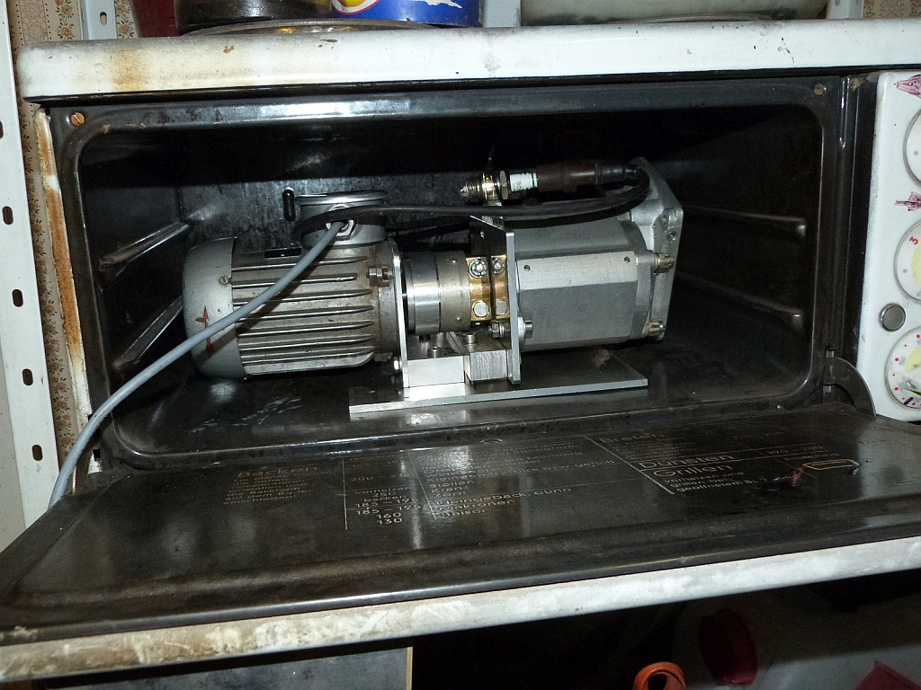

We had quite some troubles with bad/new coils in past years and this took some time to find out all sides of the problem. Since we do a mag run up AFTER most flights after clearing the runway and have min. 70 percent , better 80 percent revs to get a reliable check of ignition system.
I built my own heat chamber and did 5 hour runs at min. 70 degrees C to test coil and capacitor. Remember, the alu foil capacitor is wound between primary and secondary windings within the coil - the worst place to put a capacitor. My guess is that the dielectric material and materials in the coil wires may age and since the electrical properties of components will become unsuitable to operate.
Why do we NOT see the same hiccup of the engine when we do the mag check on the ground , switching off one mag, compared to a short failure in flight ??? I just cannot figure that out . . .
