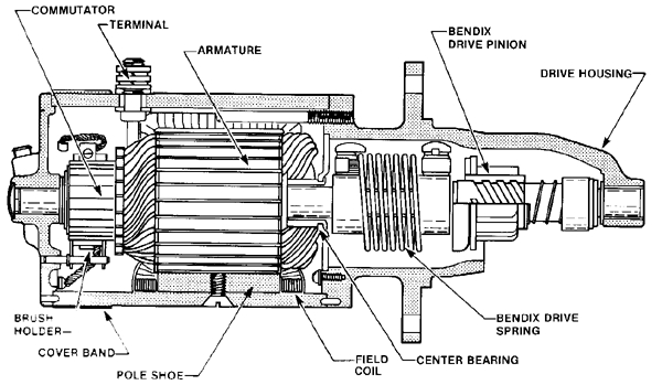

PostPosted: Wed Apr 04, 2018 1:38 pm    Post subject: Starter SURGES Reply with quote
At 03:46 PM 4/4/2018, you wrote:
If the bendix gear is sticky, such that the engine is able to drive the starter, I could imagine that it could push a fairly high (albeit short) number of joules back up the wire. Right?
the 'Bendix' drive is gone. All starters
use direct engagement solenoids.
A return spring retracts the pinion
gear upon removal of power from the
motor. In fact, electrical power to
the motor is interrupted during the initial
retraction so there is no torque being
transmitted from motor to ring gear.
At the same time, an overrun clutch
https://tinyurl.com/y7prvn7b
prevents the accelerating engine
from back-driving the starter. If
this clutch were not present, first
motion of the engine during pinion gear
retraction would break things.
This feature was built into the legacy
'bendix' drive. Starter motor acceleration
working against pinion gear mass would
drive it outward on the shaft by means
of a spiral groove on the shaft . . .
engine acceleration tending to over-run
the starter would drive the pinion back
from the ring gear with the same groove.
[img]cid:.0[/img]
There have been some hangar-tales of starter
pinions 'sticking' and back driving starters.
There have been cases of contactor sticking
keeping power on the starter thus maintaining
pinion engagement. But no back driving could
have occurred due to action of the clutch.
Had the motor been driven backwards at the
pinion to ring gear ratio, it would probably
have slung wires out of the armature and/or
stripped gear teeth.
The same gear reduction of pinion-to-ring
allows starter armature to run at several
thousand rpm to generated 200 rpm at the
crankshaft. Okay, after engine start and
run at 1000 rpm, a back-driving situation would
spin the starter armature 10000 rpm plus?
[img]cid:part5.C7D05308.20472A9D(at)gmail.com[/img]
