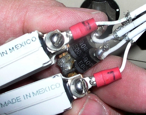

[img]cid:.0[/img]
This Electronic Ignition, dual feed, diode isolated
distribution bus has multiple connections just waiting
to fail.

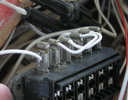

[img]cid:.1[/img]
This view shows four, plasti-grip terminals
that were either (1) improperly applied or
(2) had already regained their as-manufactured
shape due to temperature cycling. This was
a 'hands off' inspection of the wreckage
so I was unable examine more closely.

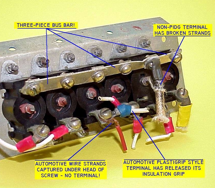

[img]cid:.2[/img]
Here's an example of lapses in craftsmanship for a breaker/bus-bar
assembly salvaged from a vintage Piper. We cannot know the time-in-
service for the variety of terminations seen here, but the PIDG
terminals demonstrate a decided advantage over the Plasti-Grip.

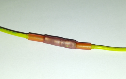

Butt splices in runs of wire tied to wire bundles can
be spliced with much less expense (and physical bulk
to the bundle) with this technique:
https://goo.gl/FMCY9K

That second picture looks like the crimps were improperly applied, with no insulation crimp at all. Even the most highbrow PIDG terminal won’t help if you don’t put it on properly.

PostPosted: Sat Apr 28, 2018 12:34 pm    Post subject: PVC vs Nylon Connectors Reply with quote
At 12:22 PM 4/28/2018, you wrote:
This electrical connection subject is very interesting to me because over the years I’ve seen several failures on my work as well as that of others. My son got me onto crimp connectors with heat shrink insulation. I’ve been using them for about 5 years now without any failures on all kinds of installations, cars, boats and aircraft. The insulation once shrunk provides support for the wire and besides insulation seals against moisture getting into the crimp. They’re available at Polar Wire in Anchorage, AK and probably many other places.
Yes, the heat-shrink, pre-insulated butt
splices are a special breed of cat. I've
messed with 'em here and been impressed
of their value . . . with reservations.
[img]cid:.0[/img]
None of my rachet-handled tools produced
adequate crimps on 22AWG wire for a RED
splice. Doubling the stranding back helps
a lot. I ultimately settled on my legacy,
hardware-store crimp too . . . put as much
'mash' on it as you can with your bare
hands.
Play with them a bit . . . do a pull test
on a sample installation. You should find
it difficult to part the splice with your
bare hands . . . and it's always good if
the wire 'breaks' as opposed to "pulls out"
at the grip.
Of course you only crimp the wire-grip. The
plastic jacket will look pretty beat up after
the crimps . . . but smooth nicely at the time
of shrinking . . . as see above.
The jacket become quite rigid . . . and the
products I tested also featured dual wall
shrink . . . in internal layer of melting
sealant.
 Filesize:  78.11 KB
 Viewed:  14604 Time(s)
