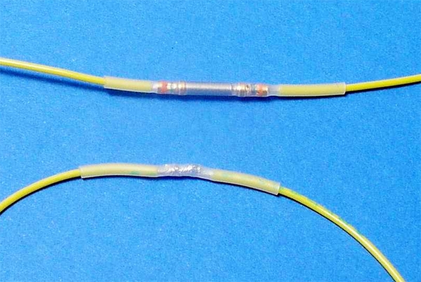

Agreed . . .
[img]cid:7.1.0.9.0.20180429085302.064f3328(at)aeroelectric.com.0[/img]
How many pins do you need? I'll include them in your order.
Got some small i.d. shrink to throw in too. Do you
have a d-sub crimp tool?

Give it a try. If push comes to shove, you
can go to knife splices under heat-shrink
or even solder-sleeves. These wires are
seldom opened for service . . . there's
probably enough slack to cut out and replace
several solder sleeves . . . by that time
you'll probably be more than ready to sell
the airplane.
The knife splice is attractive from the
perspective of wire lost during each remove
replace operation. Cutting the single terminal
off the EL panel power wire only deprives you
of 3/16" or so of wire. Cutting out a solder
sleeve would double that.
