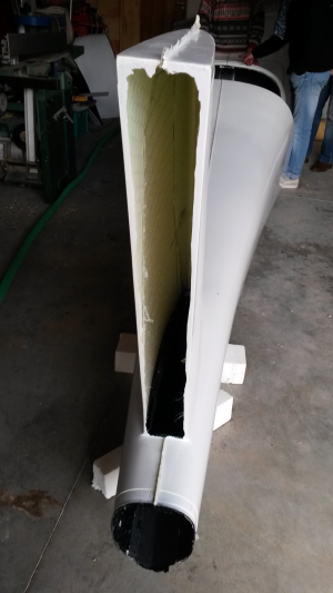

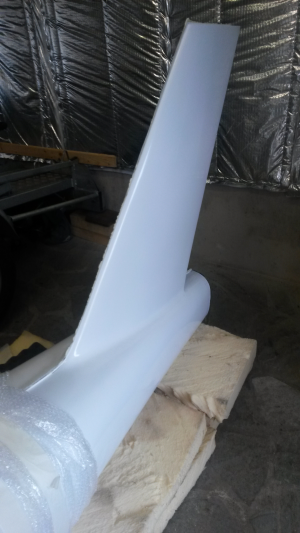

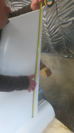

Hi Bob and all,
Reviving the antenna-in-tail subject, as the project fuselage is now assembled.
[img]cid:part1.B3949A7E.A7B2F84D(at)free.fr[/img]
Bob mentionned a promising "bazooka" configuration for the antenna, as the tail is too narrow to allow for a regular ground plane.
Here are some answers to your questions :
The entire fuselage is carbon. The vertical fin is integral with the fuselage but is made of glass for the installation of the antenna.
The fin height is ~ 0.9 m (35") while the carbon tail at the base is only 0.18 m (7") wide.
[img]cid:part2.433A4B01.02ACC99E(at)free.fr[/img][img]cid:part3.980421EA.3CA7A37E(at)free.fr[/img]
The base of the antenna will be accessible via the tail cone aperture, and crawling into the fuselage will permit limited access.
I was considering installing the radiating element in a plastic tube in the fin, so that the antenna may be easily inserted and removed.
Any suggestions as to how to devise a reasonably efficient comm antenna in the tail ?
Thanks in advance,
Best regards,
Gilles

Assuming my mental image of your configuration
is accurate, consider the following.
Terminating the antenna coax in
a BNC cable connector. Then use a BNC
chassis connector to make the mechanical
transition to the antenna and "ground
planes".
The radiating portion of the antenna obviously
needs to extend up the tube. I'd go for a
chunk of RG400 with the outer jacket and
removed from about 2" of the 'antenna' segment.
Push shields back hard exposing center conductor
Cut off center conductor
Stretch the braids out and 'tin' the last
1/4" or so with solder.
Mount chassis BNC connector to 'ground plane'.
Suggest copper sheet, 1/2" minimum to as wide as
you can fit into the tail cone. The chassis
connector can be spot-soldered to copper
sheet.
Repeat on opposite side . . .
If copper sheet is not readily available,
aluminum can be used. If the aluminum option
is selected, use the star-washer supplied with
the connector to improve electrical interface
with the ground-plane.
The 'radials' are 1/4-wave (24") extending forward
on each side of tailcone.
If you have access to an antenna analyzer (MFJ259
or similar), you can survey the installed
antenna for resonance. I suspect you'll find
that it resonates a bit low in frequency due to
proximity effects of the rudder post.
Trim antenna 1/4" at a time until SWR
minimizes at 126.5 MHz.
If post installation evaluation is impractical
or impossible, then shorten the antenna by about
5% . . . make it 23 inches.
Does this look 'doable' on your project?
The photos above have been posted at . . .
https://goo.gl/9NaAK1

forever more be inaccessible for tweeking?
Hi Bob and all,
Thanks in advance,
Best regards,
Gilles
http://contrails.free.fr
http://lapierre.skunkworks.free.fr

I would try a 1/4 wave antenna with ground plane. Of course the small diameter tail is not the ideal shape and size for a ground plane. But it might be good enough.
Joe and all,
Thank you to all who responded.
I guess I'll follow your advice and build a mock-up of the "sub-optimal" ground plane. And then conduct some experiments - for instance calling aircraft flying nearby etc.
As for other informations, the all moving tailplane is to be carbon fiber, and the carbon tips are already fabricated.
Interesting info from Jim Weir, but of use for *glass* airplanes. Also our project has a tiny vertical fin and could not accomodate a 1/2 wave antenna.
