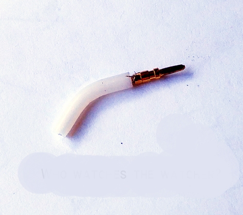

Spent too many hours and way too many dollars
chasing gremlins from an antenna system only
to discover that one of my SWR test coaxes
had an INTERMITENT short. Made for some very
confusing readings and misguided actions.
Only accidently noticed that my anomalous readings
manifested when coax behind the connector was
subject to the right side-pressure. Swapped
out the cable and the antenna refurbishment
task moved forward after replacement of stuff
that didn't need replacing.
Tore down the connector and found a couple
of 'whiskers' hanging out of the center
pin crimp.
[img]cid:7.1.0.9.0.20180526104126.056b8060(at)aeroelectric.com.0[/img]
Just long enough to come within a few micro-inches
of shorting the coax . . . putting the right
force vector on the coax would close the gap.
This was a commercially assembled test jumper
that has been hanging on my cable rack for
at least 15 years . . . just goes to show ya . . .
