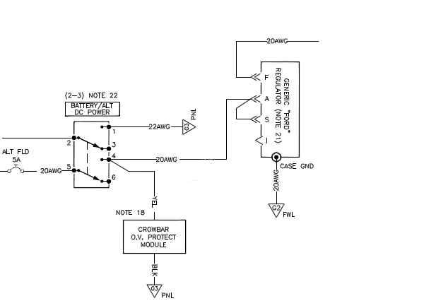

Plane Power modifies the automotive alternators
to derive field excitation from a source external
to the alternator. Same with B&C.
PP retains the built in regulator . . . for a time
they added crowbar ov protection externally. Don't
know what they do now. But even if they don't provide
ov protection, it can be easily added to the field
supply feeder. B&C's controllers for their automotive
adaptations have ov protection built in . . . their
PM product installations include/recommend the
crowbar ov protection device which COULD be used
on any other system that is not otherwise fitted
with ov protection.
[img]cid:.0[/img]
But if you have a candidate alternator regulator
that you have reason to believe it never fails
then you're certainly free to forego ov protaection.

well, i guess i should wire in a crowbar. seems like it should be pretty straight forward to have it break the circuit to the field. i will take a look in bob's book for ideas and go from there.
The crowbar ov protection module can be added to
any system wherein alternator field power is
taken through a typical 5A breaker. The
module is wired from field supply line to
ground at any point downstream of that
breaker. You can find examples in the Z-figures.
