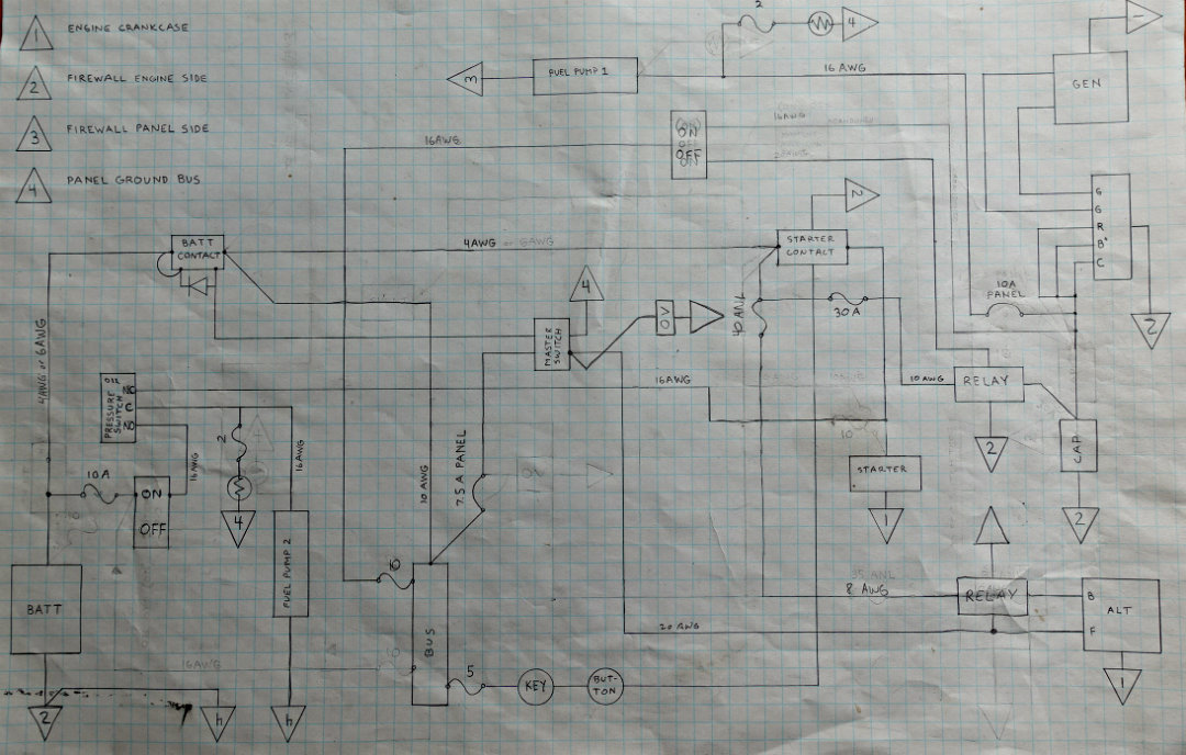

PostPosted: Thu Aug 16, 2018 9:07 am    Post subject: alternator gets hot while hangar flying Reply with quote
Bob, no I do not have a BAT only position on my master (drawing attached). Yes, I do have a field breaker that I can easily pull, and I will pull it from now on. Have I harmed my alternator by not turning it off previously?

PostPosted: Thu Aug 16, 2018 10:58 am    Post subject: alternator gets hot while hangar flying Reply with quote
that will work
No, it will be fine.
