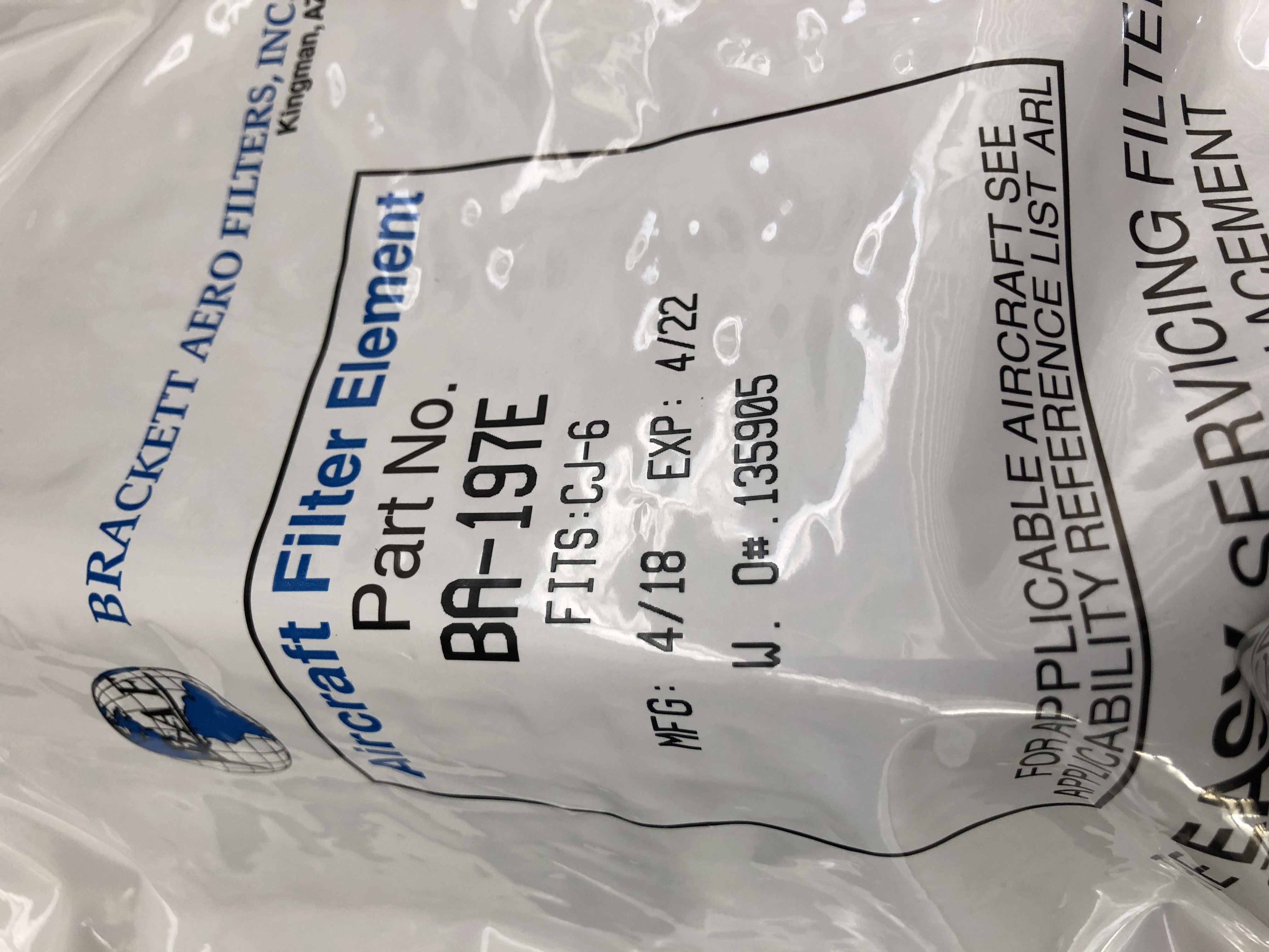

I’ve used the Brackett filter on the M-14P of my CJ for years. No significant loss of power noted. Might be over-doing this, but I change it every 50 hours.
Here's an image of the packaging. As mentioned, this is not listed in their regular catalog.

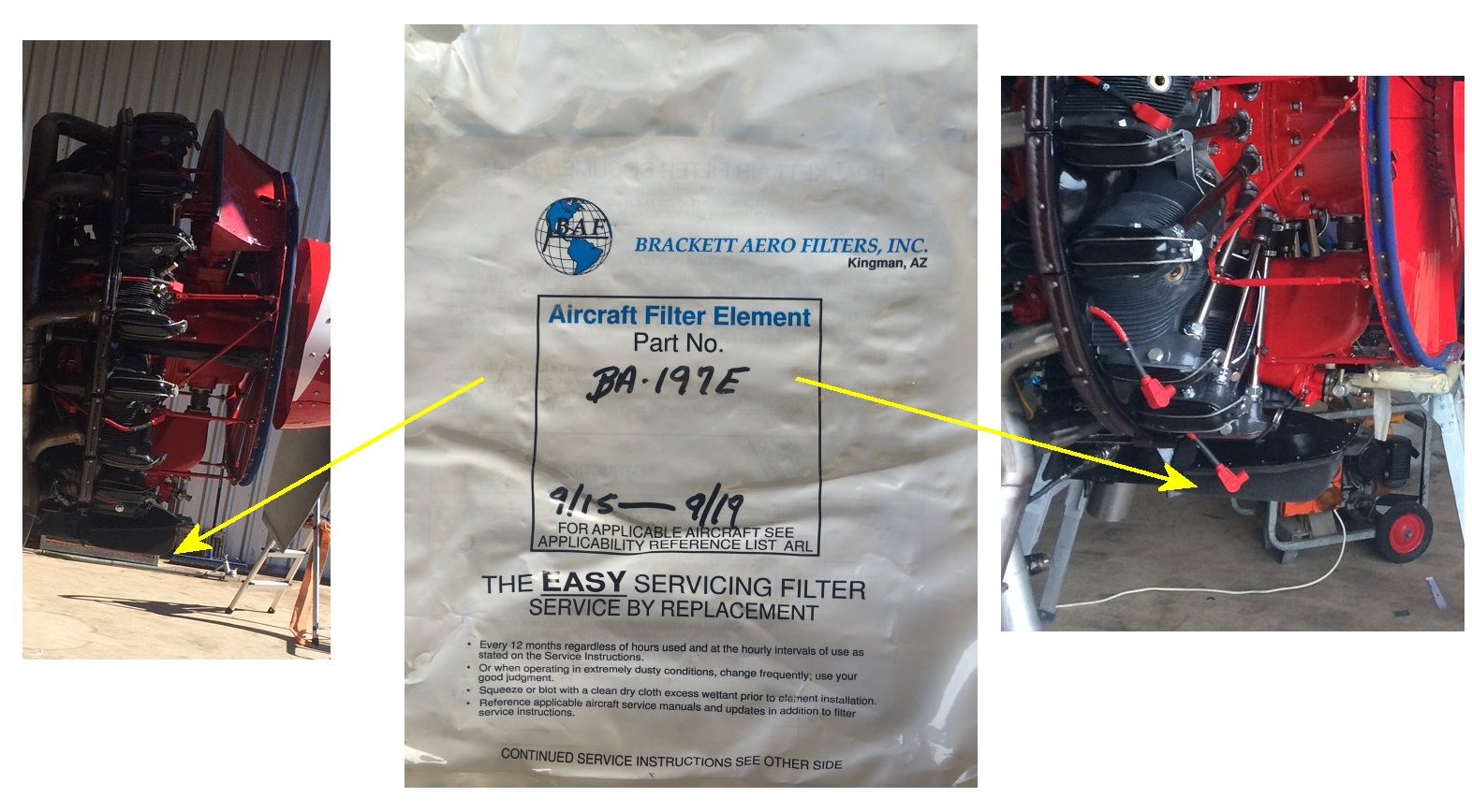

In situ

pennington.construction.i
PostPosted: Tue Aug 28, 2018 2:44 pm    Post subject: Brackett Air Filter Reply with quote
I don’t think the 50 hour cycle is over kill.
Got my M14 powered CJ two years ago.
The bracket filter on the plane was adhered to the wire frame under and had to be soaked off with AV gas.
I also change mine every 50 hours.

PostPosted: Wed Aug 29, 2018 6:03 am    Post subject: Brackett Air Filter Reply with quote
Okay, have to plead ignorance. Have not even seen this on a YAK. How does it attach to the screen?Doc
