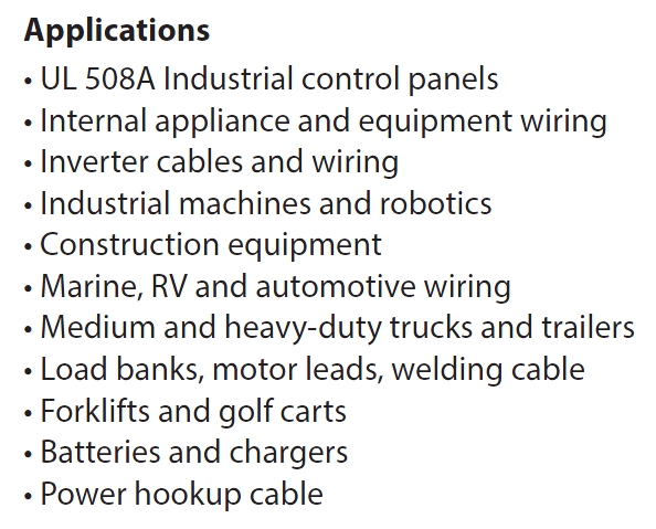

PostPosted: Sun Sep 09, 2018 12:48 pm    Post subject: Arctic super-flex wire Reply with quote
At 03:14 PM 9/9/2018, you wrote:
Bob,
My concern with similar high-strand-count wires for aircraft applications has been that the soft silicone insulation doesn't seem to offer much protection against cutting and abrasion.
What's your take on that? Just be careful to route and support it properly and avoid nicking it with tools during maintenance? Or is the insulation on this wire superior?
Henry
The samples I have don't look/feel like silicone.
The product data sheet I posted speaks to properties
of the insulation but without mentioning 'silicone'.
The same data sheet suggests a spectrum of
applications . . .
[img]cid:.0[/img]
I suspect that mechanical risks to insulation
failure in airplanes is no greater than many
of those applications cited.
"Cutting" and "abrasion" distresses will attack
ANY insulation. Installation and routing practices
should seek to eliminate such risks irrespective
of type of insulation.
