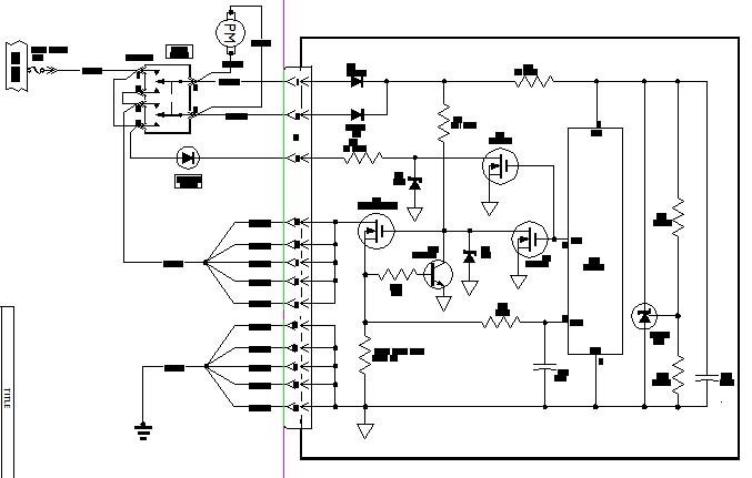

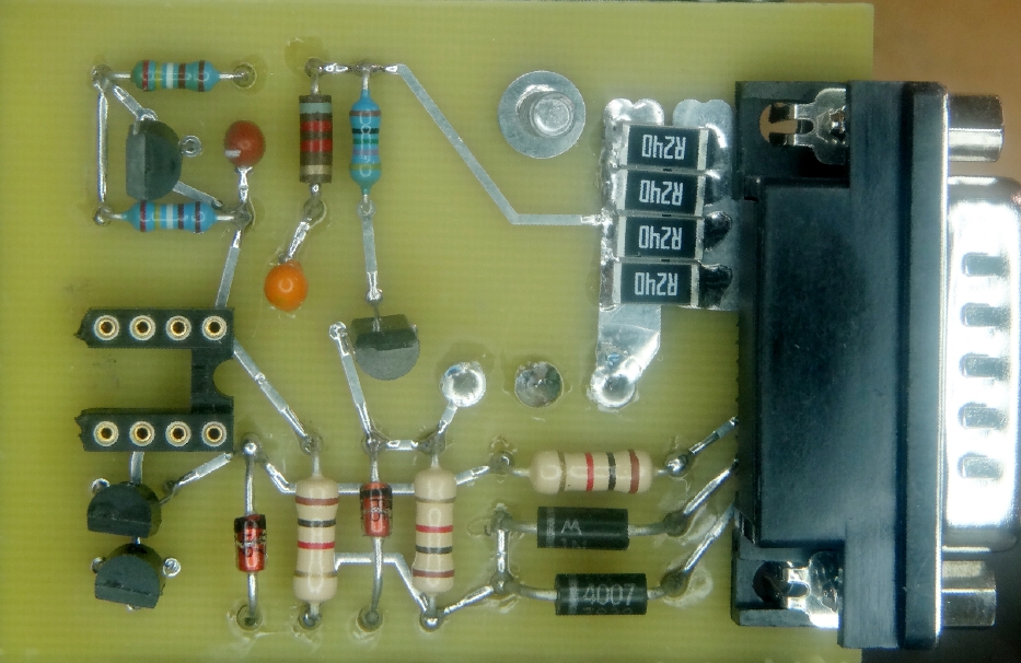

I'm a bit confused about the status of this project.
I seem to recall having laid out boards, stuffing
a prototype and handing the proof-of-concept board
off to someone to be programmed.
[img]cid:7.1.0.9.0.20180917170551.06667428(at)aeroelectric.com.0[/img]
[img]cid:7.1.0.9.0.20180917170551.06667428(at)aeroelectric.com.1[/img]
I dug around here looking for the project-bin but could not
immediately put my hands on it.
Did this fall down a crack somewhere . . . and is the crack
in my shop?
