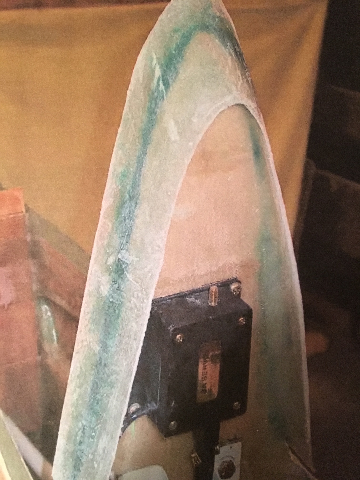

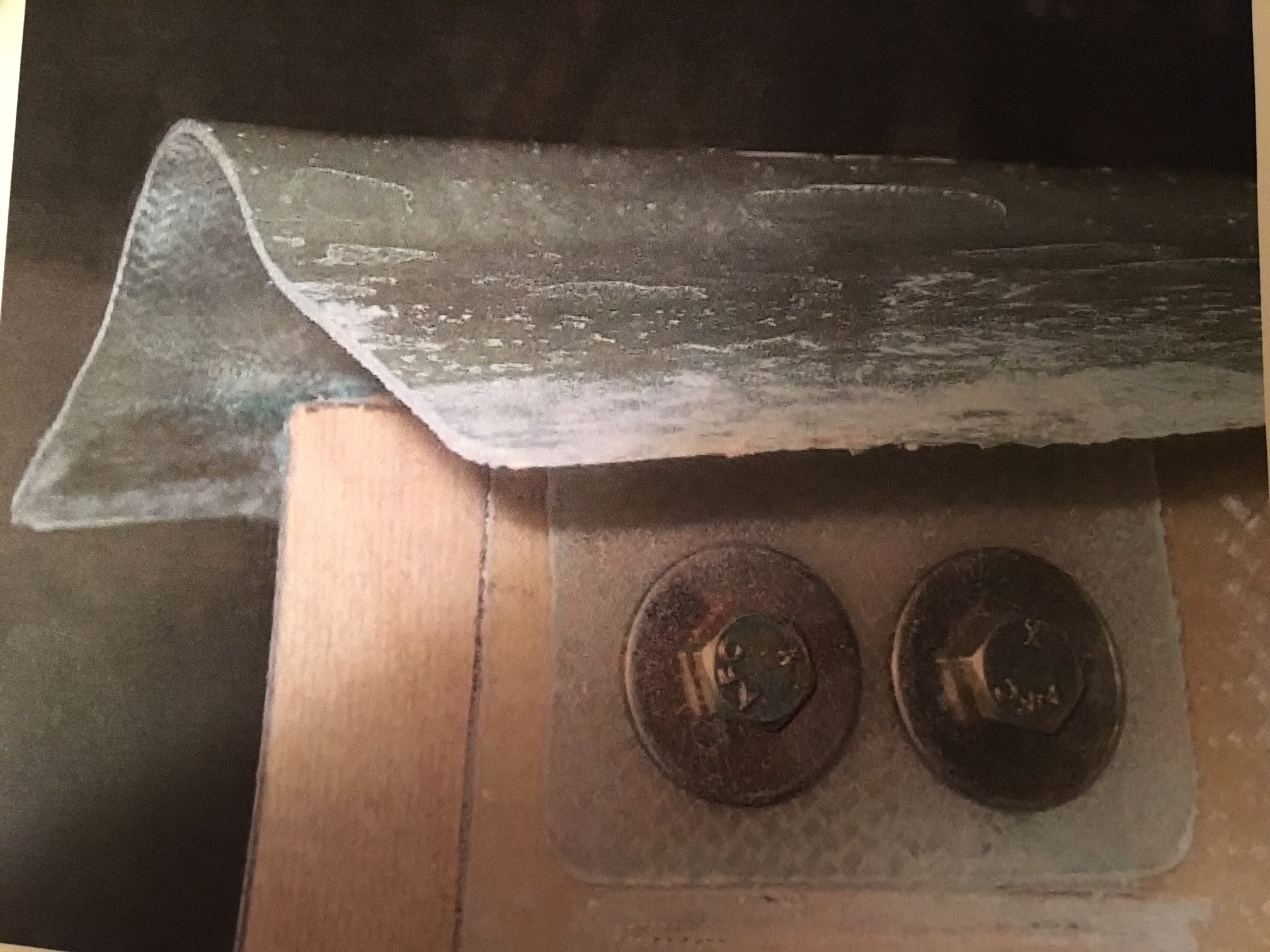

Like you, I purchased my kit from a builder that lost his hearing shortly after starting the build. One of the things I did that I found very handy later in the build was to permanently install two cleats about a foot aft of the â€śD” window that I was able to temporarily place a 3/4” reinforced plywood so I had a shelf to lay on when I had to do work back there. The â€śD” window bulkhead will not carry your weight when you lay on it. Also, prior to putting the top on, I marked the inside of the top where the mass balance tower meets it. I then made up a flash of four layers of BID. Then after it set, the next time I put the top back on, I marked where the brackets would go and attached them to the flash. Then, when ready to put the top on, I attached the flash to the top of the tower, applied a coat of Redux and flox so when the top goes on, it’ll squish out and form a great seal between the top and the top of the tower. Some other builders have done this so the tower is in permanently, but I made it so I could remove the tower if I ever had to. This can also be done on the rear bulkhead that has the trim motor mounted on it.
