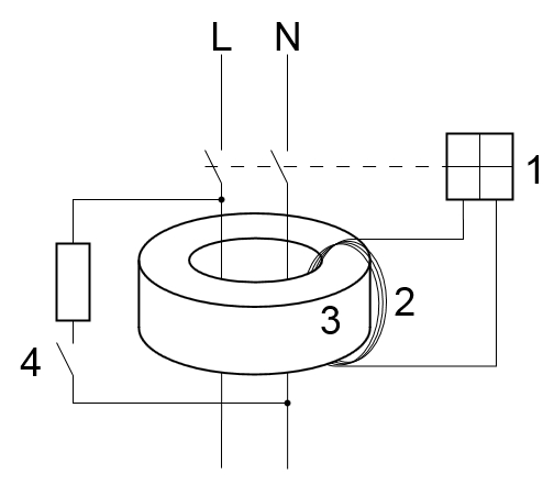

PostPosted: Sun Oct 28, 2018 10:22 am    Post subject: Same rating for fuses and circuit breakers? Reply with quote
At 11:27 AM 10/28/2018, you wrote:
Bob:
Of course GFI will not work on planes, not as yet! The present GFI for homes uses inductance in the AC circuit. Our planes are DC, inductance is not there, AC is not there! Â
The type of Ground does not matter.
[img]cid:.0[/img]
The type of 'ground' does matter. The contemporary
GFCI watches for an imbalance of current flow
between the power (line) and return (neutral)
pathways of a power distribution system. Any
small imbalance between N and L manifest
as signal in winding #2 which is processed
and used to trip the switches and disconnect
power. In this case, 'ground' is some
stray pathway out in the environment.
In our airplanes, there is no "N" conductor,
that's the airframe and we call it 'ground'.
The GFI is a prophylactic against human
hazards and not intended to protect wiring
from catastrophic overload.
If fact, the GFI cannot detect the catastrophic
overload. A downstream fault between L and N
will still present as a 'balanced' condition
which will not trip the GFI. The upstream
circuit breaker's job is to stand off
results of a catastrophic overload.
Conflating the functionality of GFIs and CBs
is in error.
All,
There appears to be a lot of mythology surrounding GFCIs (Ground Fault Circuit Interrupters) or GFI for short.
Here's how they work:
1. GFI are anti-electrocution devices. Not over-current protection devices. (A very common mis-conception)
2. The GFI measures the current on both legs of the circuit, the hot and the neutral.
3. If it detects and imbalance between the two legs, it trips. It has nothing to do with the magnitude of the overall current. That's what the circuit breaker is for. I think the imbalance is as small as 5 mA (not sure but it is pretty small).
The theory is that if, for example, the hot leg is conducting 1000 mA but the current in the returning neutral is only 995mA, then 5mA of stray current is going somewhere bad, like thru your heart to ground.
Side Note (for electrical contractors):
Therefore a GFI cannot be use on a shared-neutral circuit - if you don't know what that is, don't worry about it. It is a fairly common practice in house wiring.
Take it from a 'company man' . . . RIGHT ON.
