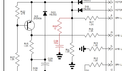

On Mon, 29 May 2017 at 18:04, Robert L. Nuckolls, III <nuckolls.bob(at)aeroelectric.com (nuckolls.bob(at)aeroelectric.com)> wrote:
At 11:06 PM 5/27/2017, you wrote:
with the engine off, the prop and circuit behaved normally.  With the engine running, the prop current is shut down almost immediately, though a small bit of pitch change does occur prior to cut-off.
Doug
Could this have something to do with the higher system voltage when the engine is running?
  possibly . . . but I think not. The
  current limiter is configured to 'latch'
  into an OFF state approx 200 mS after
  a current limit on the order of 9A is
  achieved.
  The 'latch' is subject to premature triggering
  if subjected to noise which I suspect is coming
  from the ship's alternator.
[img]cid:166cf7ef43a4ec4f5b01[/img]
  Doug,
  Try tacking this combination of components onto
  your assembly. The experiment is to see if adding
  a smoothing capacitor to the circuit's power
  source will sufficiently attenuate the antagonistic
  energies. The 100 uF cap is the 'smoother' while
  the 10 ohm resistor mitigates inrush currents impressed
  on the circuit when the directional control switch
  closes . . .
