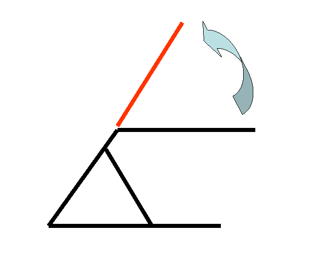

Some 15 years ago we ordered a Bob Archer comm antenna for installation in our wingtip, and have been very satisfied with it.
Here is a sketch of our 15 year old antenna :
[img]cid:part1.300707EA.6D7F4BA4(at)free.fr[/img]
A buddy of mine launches into another project and just received a new Archer antenna to install in his tail fin, but the dimensions and shape seem different, and the rivets prevent the upper segment from being swept up to fit into the tail.
Although the antenna is labelled "Comm", we are finally not sure the model is a VHF one.
Does any of you gentlemen have any information as to the shape and dimensions of the present time Archer comm antennas - or VOR antennas - so we could clarify the matter ?

Pretty sure that if you could see side by side images of all the Sportcraft antennas, you'd see significant differences among the various antennas.  IIRC, there are different models for RV-4-8, the -9, & -10 wing tips. The vertical fin would be yet another design. The VOR antennas would be yet another set.
Did he make sure that the model he bought is recommended for his a/c, and for the location where he intends to mount it?

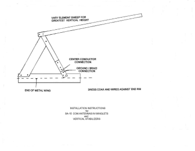

The antenna is to be located in the glass fiber fin, but as it is a small airplane, there no room for
a 1/2 wave antenna.
Provided the model is a correct comm antenna the actual question is, can we pivot the radiating element so as to match the fin, like in red in the following diagram
[img]cid:part1.258513B1.2B89A41E(at)free.fr[/img]
Of course this would involve removing some rivets, but from an electrical point of view, would such a "sweep" be acceptable ?

I'm no antenna expert, but I'd bet that a base loaded whip (like a 'rubber ducky' off a handheld) would work about as well as  radically altering the tuning of the Archer antenna. Or maybe not. Smile

The Archer antenna should work better with the radiating element unbent. In fact, it would work best with the radiating element at 90 degrees to the base. But you might have a bigger issue. This antenna requires a mass of metal, like a wing, electrically connected along the base to serve as a ground plane. Does the aircraft have a metal fuselage or stabilizer.
Another issue is the rudder tube, if metal. If the distance from the front of the rudder to the antenna radiator is too short, say around a foot or two, you will have a null in your reception toward the rear. The problem is even worse if the rudder is also metal.
A possible solution might be a bent 1/2 wave dipole. The 1/4 wave part fed by the coax center wire would fit up the fin from the base, essentially the same as the radiating element on the Archer. The other half of the dipole would be attached forward to the underside of the fuselage top. The shield of the coax would be attached to this other half. Sort of an L in profile from the right side with the coax cable attached at the bend. I would use copper sheet 1/2 - 3/4 inch wide for the elements.
If this simple antenna is not possible for some reason then more complex arrangements start appearing such as dual end coil loaded dipoles. This could be made to fit in the fin but then you are getting into the area of much tinkering and antenna analyzers, etc.

What model Archer antenna does your friend have. Archer offers a compressed dipole (looks like a weird "3") model SA006 which is 26.5" tall by 12" wide.
At some $190 it is a bit pricey but should fit if your unbent wing tip model would have.

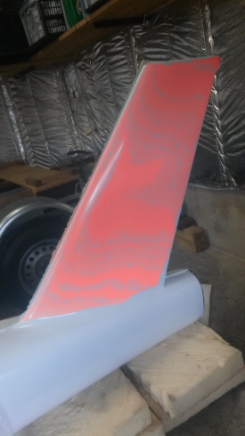

Here are some info about the present project :
It is a very small airplane, in the 100hp/140kt cruise category.
The fuselage is carbon fiber, with the fin, rudder post and rudder intentionally made of glass fiber (shown in red below) :
[img]cid:part1.FEECB98A.94C8A71D(at)free.fr[/img]
We will try to "unbend" the radiating element to have it more perpendicular to the base/ground element and fit in the tail fin, and as advised I'll borrow a SWR-meter to verify this does not harm the antenna efficiency.
Our intention is to use the same principle as in our first project to connect the antenna ground element to the carbon fuselage.

At the time Bob Archer kindly answered our many questions, and here is how we installed the antenna with great success :
The antenna is located in the right wingtip, intentionally made of glass instead of carbon as the rest of the airplane :
Mr Archer told us that would could "unbend" the radiating element to match the wingtip shape.
He also gave his advice on how to connect the ground element to the wing carbon skin :

As mentioned in a previous message, we have had great success with Bob Archer's wingtip antenna, possibly due to the carbon fiber wing playing the role of the metallic structure ?
We took special care to ensure good electrical contact between the antenna ground element and the carbon wing skin.
Also our wingtip curves up to vertical, so the radiating element is nearly vertical, which may have helped.
