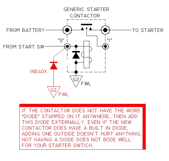

At 07:14 PM 12/24/2018, you wrote:
We had a strange event last week with our O-200 powered CH750. After running the battery down during a fuel gauge calibration that lasted over an hour, one of our pilots tried to start the engine to taxi back but with the already depleted battery and a less than perfect start procedure they gave up after a couple weak start attempts. I walked over to the aircraft to brief them on a prop start and when I asked for the master on the starter ran.
The vast majority of starter contactor
sticking events occur during an attempt
to crank the engine with a weak battery.
The fact that you got immediate starter
action on closure of the master switch
says your starter contactor was 'stuck'
shut.
Shut the master off, cycled the start button rapidly a dozen times, master on again and the starter ran again. I could hear the starter relay clicking loudly each time power was applied so it does not seem like there was a physical failure of the relay but more some electrical short activating the relay each time power was applied.
Contacts are welded . . .
The build team inspected the relay and found a loose connection. Tightening it took the problem from continuous to intermittent; in their words "it's fixed but it did it again once".
We have removed the relay for replacement, I still think the switch is suspect but they've decided the problem is the relay. Does the aeroelectric list think there would be value in cutting open the relay and examining it? Any suggestions on how best to do so?
Go to a car parts store and pick
up a starter contactor that looks
like the one in the aircraft spruce
catalog . . . it will work just fine.
See if the contactor is marked "diode
suppressed" or has the word diode on it
anywhere or on the packaging.
[img]cid:.0[/img]
 Filesize:  156.73 KB
 Viewed:  17960 Time(s)

cluros(at)gmail.com
PostPosted: Fri Jan 04, 2019 2:44 pm    Post subject: Relay sticking Reply with quote
Upon examination of the removed starter relay I see that it is a continuous duty relay. It has now been replaced with an intermittent duty relay of appropriate capacity. Thank you for the help everyone but looks like this one was obvious.
On Thu, Dec 27, 2018 at 9:18 AM Robert L. Nuckolls, III <nuckolls.bob(at)aeroelectric.com (nuckolls.bob(at)aeroelectric.com)> wrote:
 shut.
[img]cid:1681b04e58bd7b6b1d31[/img]
 Filesize:  156.73 KB
 Viewed:  17890 Time(s)
