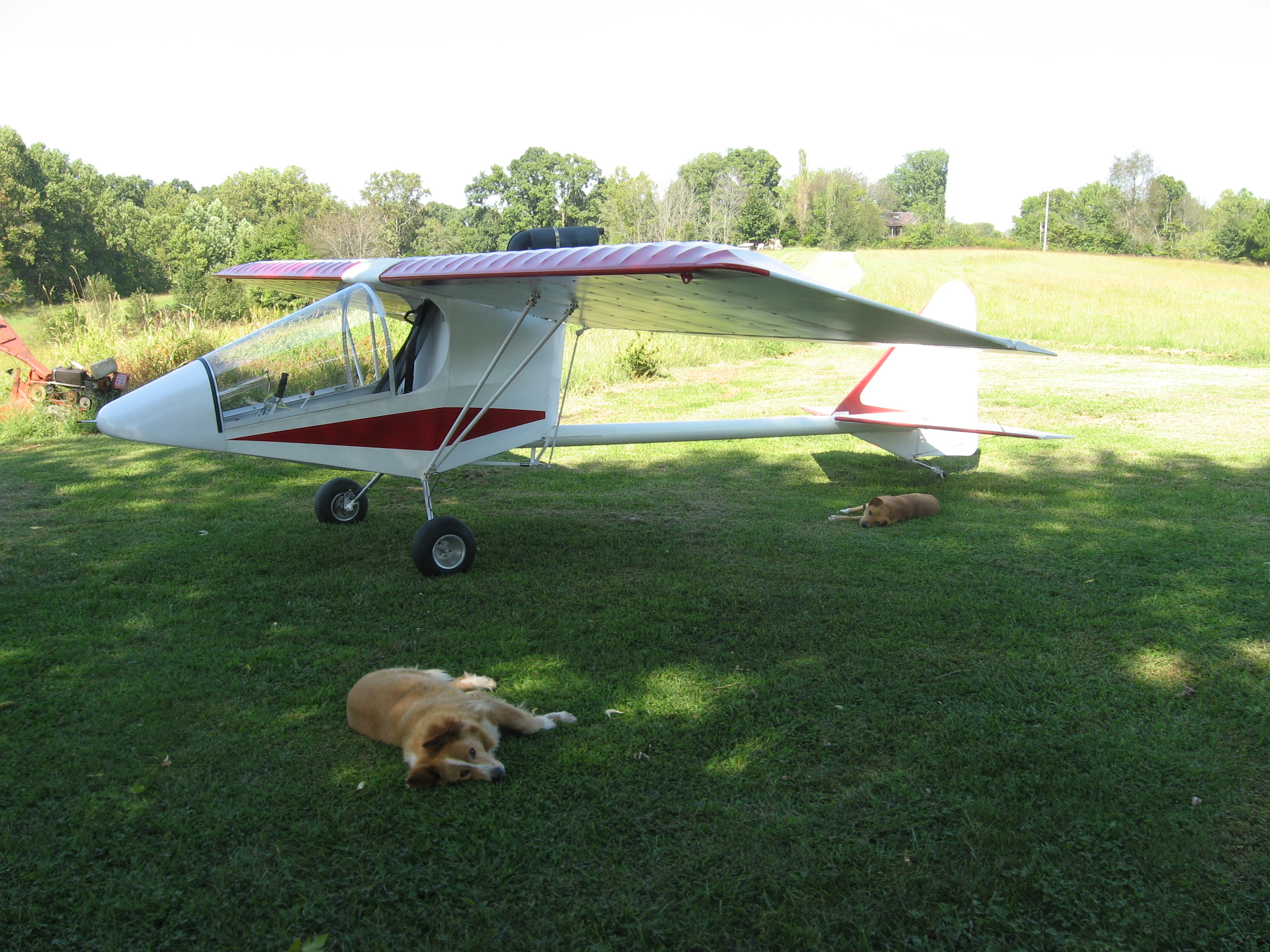

this pic shows the full enclosure...it fastens with a inch by inch angle to the top longeron on the left side and two rivets at 8 and 10 am on the left side of the nose cone and the rear bow allow the right side to lift completely up...The right angle aluminum is fastened to the lexan and has a tapered screw at the front of the angle that slides into a hole in the tab that holds the nose bowl...the rear of the angle has a latch... To enter...just don a cap and raise the lexan and rest it on your head.... Keeps the hair oil off of the lexan!! Smile
   This bird got "factory built" raves from the kolb guys in the St. Louis area...Very satisfying..guess if one does it enough...good things can happen...kids in the other example....Smile   Herb [img]cid:f40a0442(at)protonmail.ch[/img]

That is one pretty Kolb! The pups don't look like they're in need at all, but if they're like mine a treat is always acceptable.
Rick
