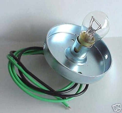

Over the years, I have had occasion to open factory
assembled connectors that were obviously offered
the benefits of protection above and beyond those
offered by the enclosure. This includes lamp sockets
on tail and back-up lights, marker lights and
yes, trailer connectors.
These instances were most common on fixtures
especially exposed to splash or run-down. When
refurbishing equipment that succumbed to
contamination induced corrosion, the
'rule of thumb' called for protecting
the replacement hardware with a good
dielectric grease. But it was also a good
idea to see if some gasket had failed
allowing ingress of moisture.
[img]cid:.0[/img]

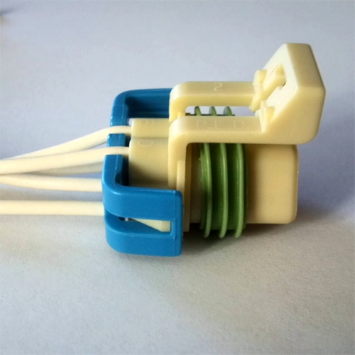

In years since, designers for electrical
connectors improved designs to improve
performance in harsh environments.
The moisture seal bellows on this
connector is one example.
[img]cid:.1[/img]

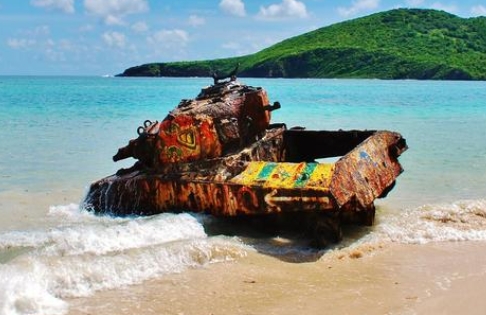

There is a tank on the beach of
Culebra Island, PR that has been sitting
there since WWII. Dug around through
the interior a few years back.

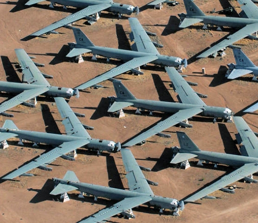

[img]cid:.0[/img]
The salt water has literally dissolved
major cross sections of steel. On the
other hand, one could have stored this
machine next to a tenant of the Davis
Monthan 'bone yard' . .
[img]cid:.1[/img]
. . . and the machine might well be
operational with nothing more than some
fuel and a grease job.
