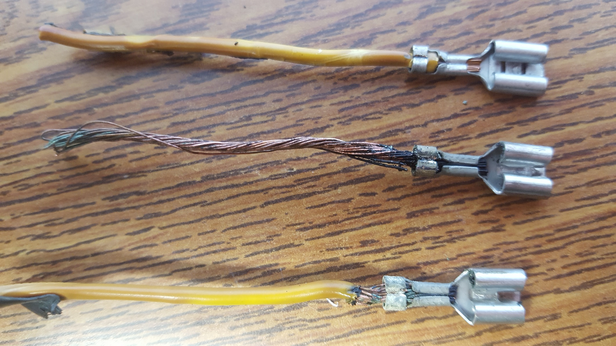

Recently, while inspecting the engine compartment after some routine maintenance, I noted a section of "browned and crispy" wire insulation. This particular wire was one of the 3 phase wires which come from the 30A PMA associated with the engine. The brown and crispy portion was at the back of a plastic 6 blade connector half where crimped 1/4 female spade connectors are inserted to mate with the Regulator/Rectifier. The crimps are good, all spades firmly seated into the shell, though the spade (associated with the browned wire) location on the shell also show sign of getting too hot. But only at the one spade connection. Overheating due to high resistance is the only thing that comes to mind. I did apply dielectric grease to these particular spades to help them fully mate and as a corrosion/moisture preventative. I do this routinely on older cars up here in the Northeast with no issues. Could this be a problem? I typically draw 18-22 amps load while flying but when topping off the batteries will draw closer to 30 amps for 10-15 minutes of flying if the batteries have been drawn down for extended times during non flight activity. Note that the output from the R/R looked fine but they are a larger gauge wire. (12ga versus 14ga of the 3 phase wires into the R/R) Rather lengthy problem description for what appear to be an overheated wire, open for all thoughts or ideas. The only one I can come up with is poor connection / high resistance, though not sure of the mechanism. Thanks, Happy New Year to all!!

Le 01/01/2019 à 18:49, blues750 a écrit :
I did apply dielectric grease to these particular spades to help them fully mate and as a corrosion/moisture preventative. I do this routinely on older cars up here in the Northeast with no issues. Could this be a problem? I routinely draw 18-22 amps while flying but when topp!
Hello,
Just to mention that "dielectric" means "insulating".
Don't know if this is a problem, but gas tight metal to metal is key.
Rather lengthy problem description for what appear to be an overheated wire, open for all thoughts or ideas. The only one I can come up with is poor connection, though not sure of the mechanism.
We have had the same issue with some wires off the voltage regulator
connector. We replaced the wires and spade terminal, paying attention to
the quality of the crimp.
Happy New Year !
Best regards,
Gilles
http://contrails.free.fr
http://lapierre.skunkworks.free.fr
blues750
Joined: 06 Jun 2015
Posts: 56
PostPosted: Tue Jan 01, 2019 12:54 pm    Post subject: Re: When / where to use dielectric grease? Reply with quote
Gilles, I think you may be on to something! I likely "gobbed" on too much dielectric grease and prevented a good electrical connection as the grease heated up and spread over the metal to metal connections. My plan is to clean up and replace the connections, reassemble with no dielectric grease! Thanks for the reply. Cheers! Dave
user9253
Joined: 28 Mar 2008
Posts: 1978
Location: Riley TWP Michigan
PostPosted: Tue Jan 01, 2019 5:45 pm    Post subject: Re: When / where to use dielectric grease? Reply with quote
Most common grease is dielectric. Its use should not cause a problem. A properly crimped joint forces all grease out from between the metals. I have coated automotive battery terminals with grease and the vehicle still starts fine. The problem is due to a bad crimp.

blues750
Joined: 06 Jun 2015
Posts: 56
PostPosted: Wed Jan 02, 2019 4:38 am    Post subject: Re: When / where to use dielectric grease? Reply with quote
Here are a few pics of the connector in case anything can be determined by the pic. Will post pics of crimps when I remove wires and assess. Thanks for the input all. Dave

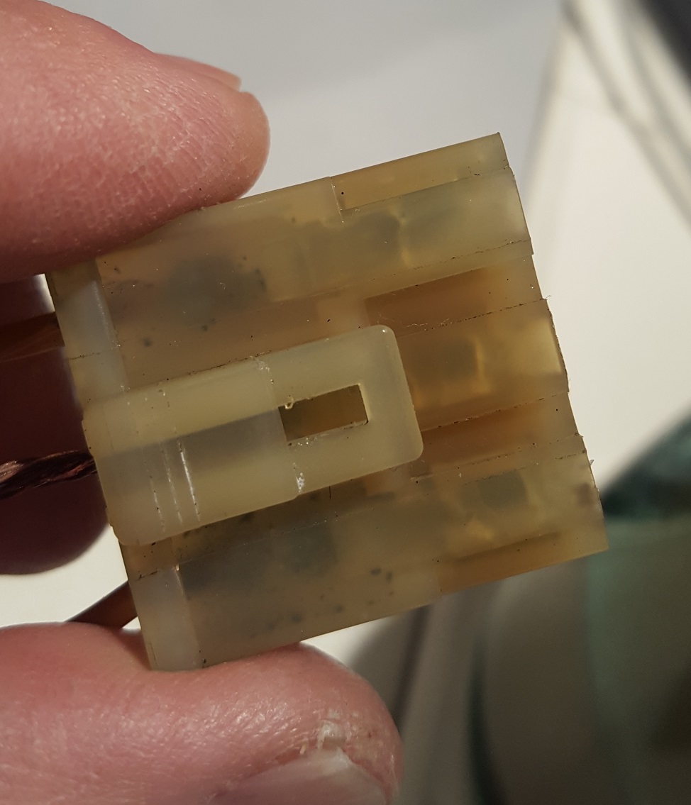

blues750
Joined: 06 Jun 2015
Posts: 56
PostPosted: Wed Jan 02, 2019 4:36 pm    Post subject: Re: When / where to use dielectric grease? Reply with quote
OK, had a chance to remove the wires from the connector shell. I would like to think all my crimps looked like the "good looking crimp and wire" I cannot imagine I would have proceeded without having them otherwise. But... the other wires look pretty p*ss poor! The bare wire had hardened insulation which I peeled off to inspect wire condition. Seems like a lot of corrosion for such a "young" connection! In reading Bob's related reply, I can easily be lead to believe that those (my) crimps are in the "neophyte" category for these particular terminals. I cannot recall the crimp tool name I used, but it is oe I purchased from SteinAir expressedly for doing open barrel crimps. Thoughts, insights, and opinions??
