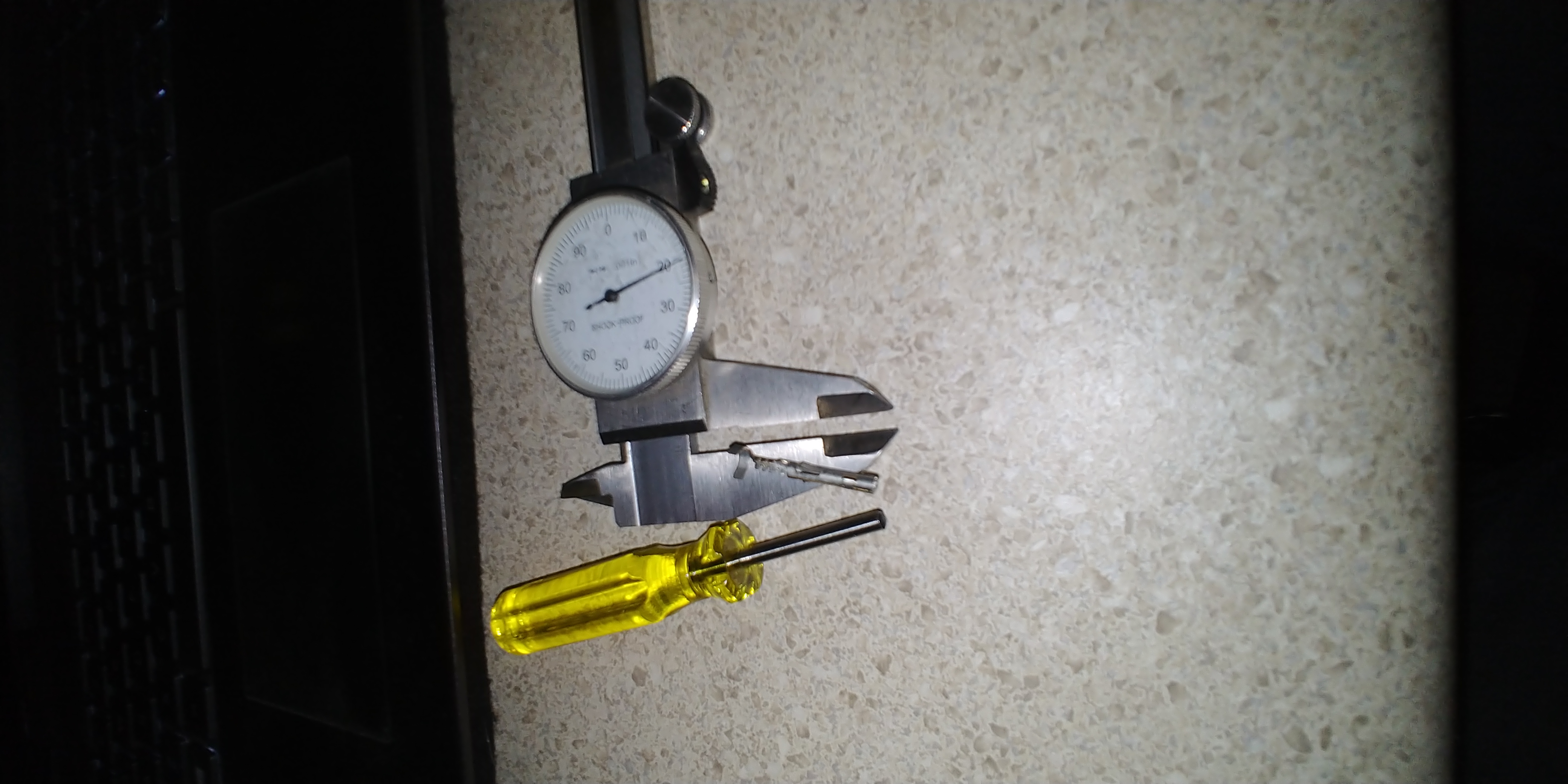

I bought the B0040CRUNO yellow handled hollow tip tool however the ID of the
hollow tip is 0.020 inches so this hollow tube is perfect for slipping over
the weather pack pins however the weather pack sockets have a thicker OD and
therefore the hollow tip of this tool does not slip over the socket.

Here is a picture of the tool that I'm trying to use and it's ID is too narrow to fit over the 24-22 AWG socket.
Bill Hunter

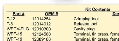

The White Products catalog page 24 shows
only one part number for an extraction
tool.
[img]cid:7.1.0.9.0.20190204120635.05369bd0(at)aeroelectric.com.0[/img]
So I'm assuming that the T-3 tool is
designed to extract both types of pin.
I'm skeptical of the 0.020" measurement
you cited . . . those pins are much
larger . . . did you 'zero' the
caliper before making the measurement?
Measurements aside, the single tool
should work with both pins and
sockets. You may have the wrong
tool.

So I did find the problem…It appears that the female “socket” was opened up a little bit whilst I was trying to ram the tower into the shroud and because the pin was not centered in the tower it tried to enter the socket a bit sideways and loostened up the socket wider than normal so I could not get the tool over the socket. The use of the correct combination of bad words plus the use of a magnifying glass head light and a small screwdriver did the trick!!!
Now my pin will easily insert into the socket and the connection is electric!!!
