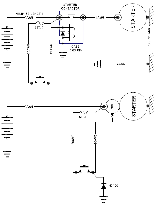

Consider these options:
[img]cid:.0[/img]
If your starter has a built in contactor/
solenoid (as most modern offers do), consider the
second drawing. If the starter has no
contactor with an alternative engagement
mechanism, then the first drawing is worth
consideration.
If you're planning on having the battery 'maintained'
between flights, it could be quite small assuming
it's capable of the necessary cranking currents.

hivanhaecker(at)gmail.com
PostPosted: Tue Mar 12, 2019 8:03 am    Post subject: Total Loss Electrical System Reply with quote
The starter is a B&C for a C-85-12 Continental. The B&C kit came with a starter contactor, but does have a jumper wire on the back of the starter. The battery I chose is Shorai lithium/iron motorcycle type (LFX18L1-BS12) with 18Ah. Note:preliminary tests show that it will spin the prop quite rapidly! I do like the idea of a manual interuption of the battery ground wire to disconnect the battery.

PostPosted: Tue Mar 12, 2019 8:56 am    Post subject: Total Loss Electrical System Reply with quote
Yes, that's probably the easiest legacy
engine to get started. The lithium battery
should do the job. A battery switch wouldn't
hurt anything . . . but as long as you
keep the battery 'maintained', likelihood
of contactor welding is nil.
You could use either of the wiring diagrams
I posted. If you use the external contactor,
then you'll need to add the jumper wire from
"main" to "S" terminals on the starter
engagement solenoid/contactor.

PostPosted: Tue Mar 12, 2019 10:41 am    Post subject: Total Loss Electrical System Reply with quote
At 01:25 PM 3/12/2019, you wrote:
I may want to run a hand-held gps or an I-pad. And an intercom for the occasional passenger. Thje plane is mainly used for local low and slow joy riding. And have no fear Ernest. I have no intension of exploring the welding capacity of that battery, especially when installed in my airplane!Â
Okay, bring power to those devices
through an in-line fuse right at the
hot side of the starter contactor.
No other switching necessary . . .
no bus structure.
Starting the engine takes but a few
percent off the battery. Running a
few mini electro-whizzies for the
duration of the flight is trivial.
Wouldn't make this any more complicated
than it needs to be . . .
