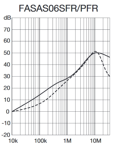

Okay, this is a WAG but and inexpensive
experiment. Without getting into an EMC
lab to 'sniff out' characteristics
of the evil triad (victim/propagation-path/
victim), I'll guess that the remote receiver
in the filter is suffering conducted
interference from the lighting power
conditioners. Get one of these things
https://tinyurl.com/yywphdh8
and install it on your filter. This
will convert the cord on the filter
into the same style as your computer.
The filter's attenuation characteristics
look like this
[img]cid:7.1.0.9.0.20190325111420.05a3f320(at)aeroelectric.com.0[/img]
Not really significant below 30 Khz
or so . . . so I'm hoping that your
lighting power conditioners operated
above that frequency.
