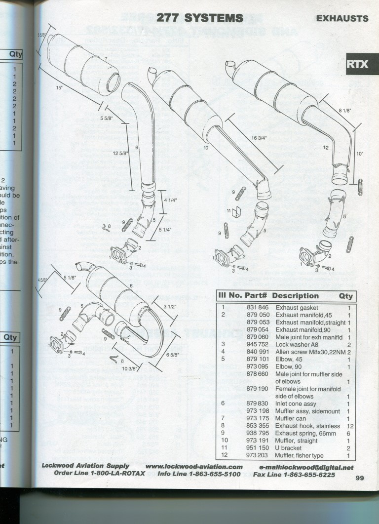

Well, yes and no, I am starting to think no.
The original pipe was a curlyque like the one in the bottom left of the attachment, but we wanted to try something to reduce the engine vibration, and I found a supplier of tapered cones for people who are fabricating their own exhausts and headers. Short version; got a cone that was exactly the right taper and diameter at both the top and bottom when cut to the length as referenced according to the top center pipe in the catalog. At 16 3/4" long, the top diameter where it welds to the can is the same as the diameter of the opening in the can. The diameter at the bottom (small end) is the same as the diameter of the 879-190 female joint connection.
Consequently I would have bet money that the straight section would be identical to a stock Rotax pipe with that configuration, but I am starting to think it is not.
Flew it twice last night, took a bit of pitch out of the prop each time, trying to compensate for it maybe being overpropped; this chart shows the correct prop diameter and pitch for a 277: http://www.ultralightnews.ca/articles/rotaxproprecommendation.htm

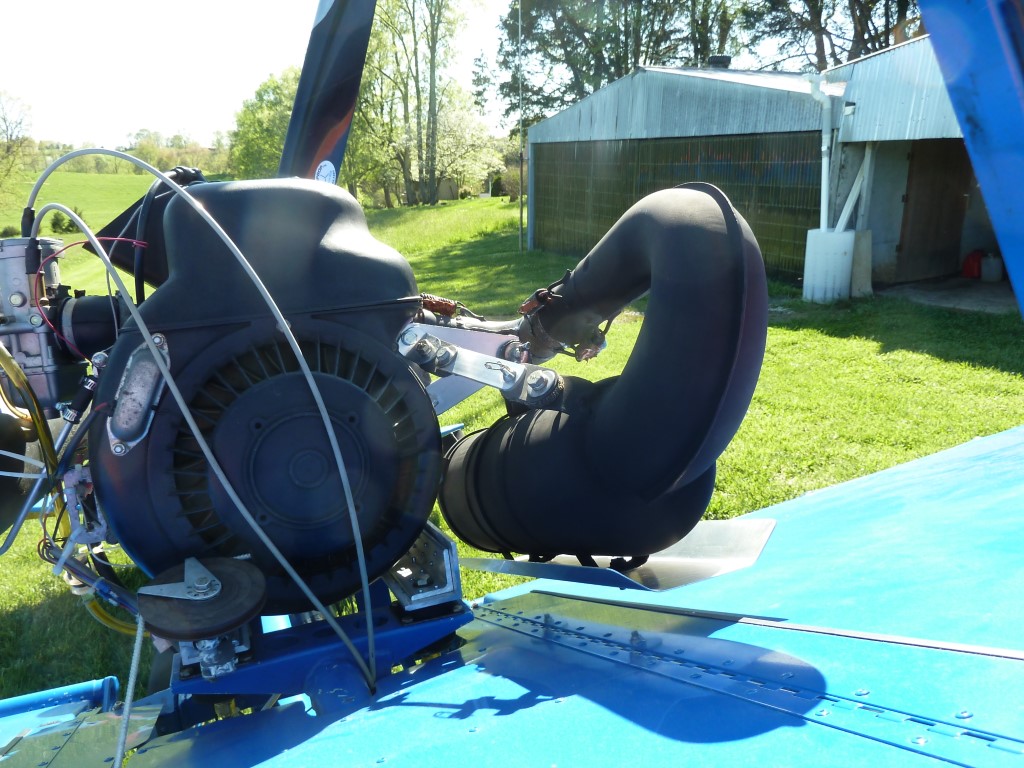

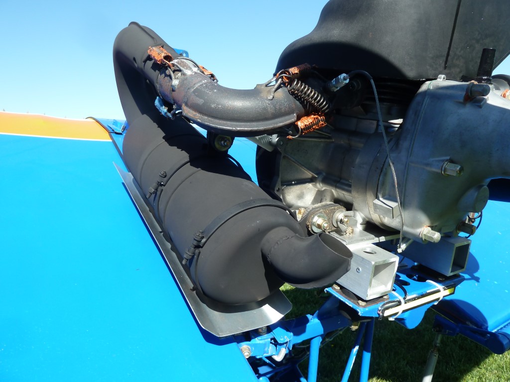

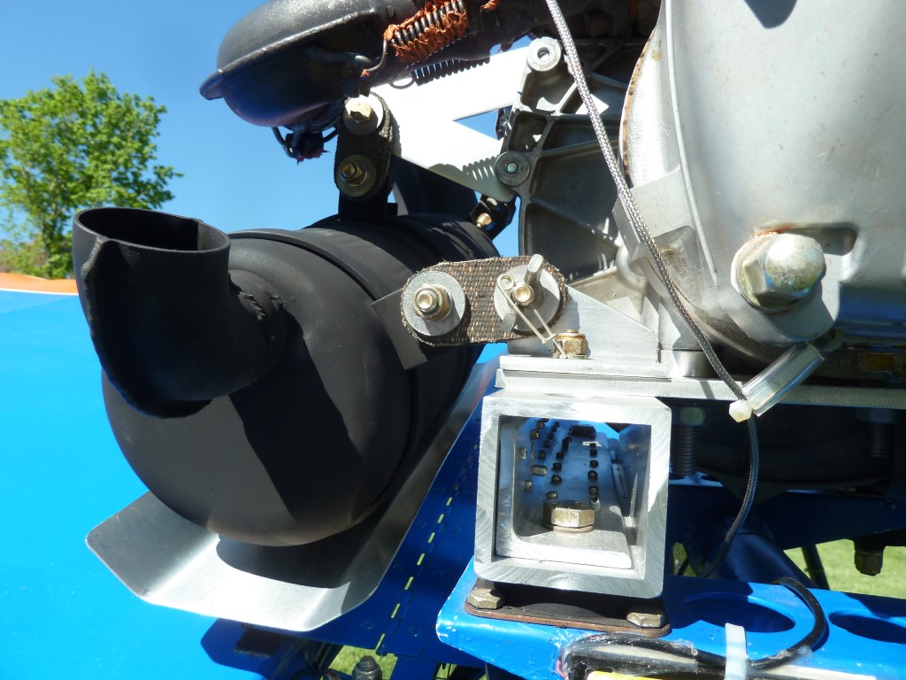

I think we are back on track, new muffler installation, flew it six times this evening, the vibration is gone. So we are half way home. Also came to the conclusion that the prop is too long and the engine is too loaded down. As long as you keep the Firefly in a shallow descent, the engine does not hunt at all, it stays at a constant throttle setting. Raise the nose and load up the prop and it falls off the pipe.
So now we need to learn what is a good length of prop for a 277 with a 2.58:1 gearbox.

Sorry to change the subject but I see a white strip on the back of the Kolb part of the motor mount. What is it.
