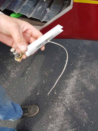

Had an elevator pitch servo fail on a flight yesterday. The cable
pulled out of a hole that uses a set screw to hold the cable in place.
It's a TruTrak pitch servo. It uses a cable that wraps around a drum.
Each end of the cable is attached to an aluminum channel.
1200 hours on the airplane with no prior issues. The pilot said the
elevator felt funny on any up travel past neutral. He also heard a
clicking noise as it passed the neutral point.
An engineering EC would be to leave the cable slightly long and crimp
a sleeve onto the cable as a a failsafe for the set screw(s).
I will call TruTrak tomorrow to see if this should be replaced or
repaired. I will be adding this to my inspection checklist. I
noticed nothing during the last condition inspection.
Not sure exactly when it failed. It was noticed prior to a return
flight from another airport. Removal of the bulkhead and removing the
control arm of the servo from the elevator bellcrank was done to allow
the flight home.

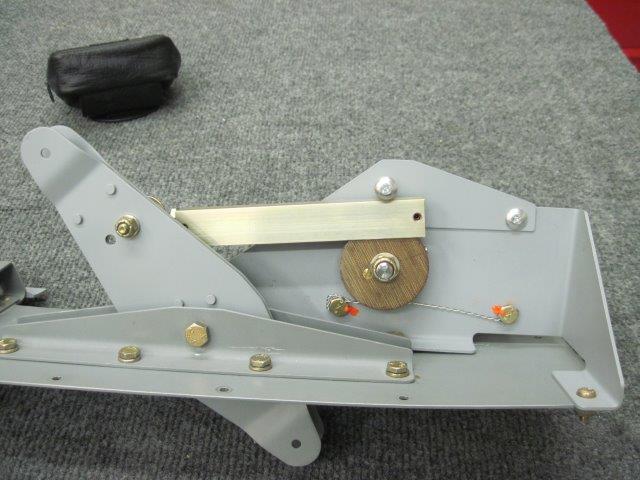

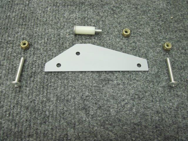

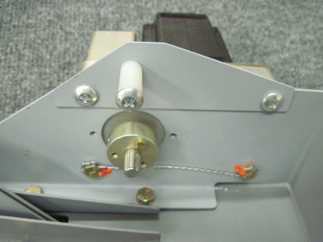

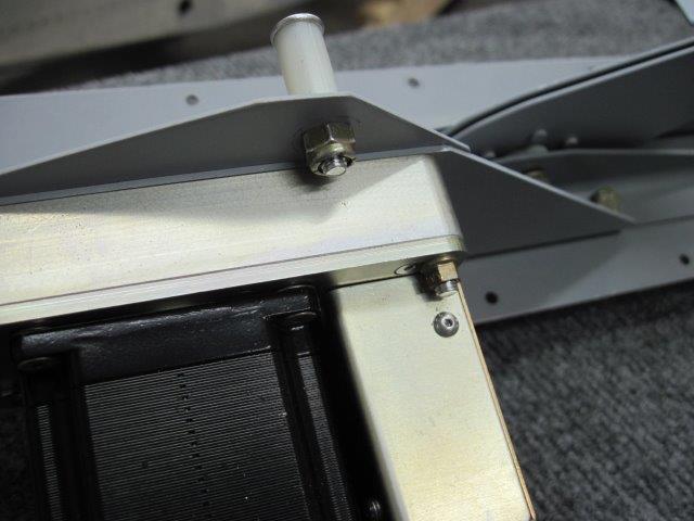

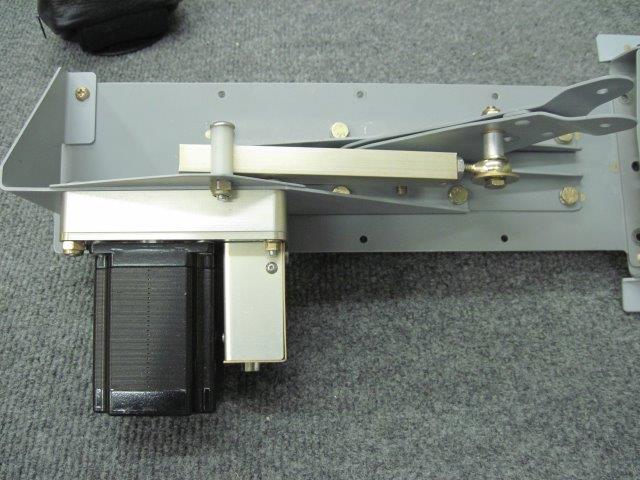

Hi Jim,

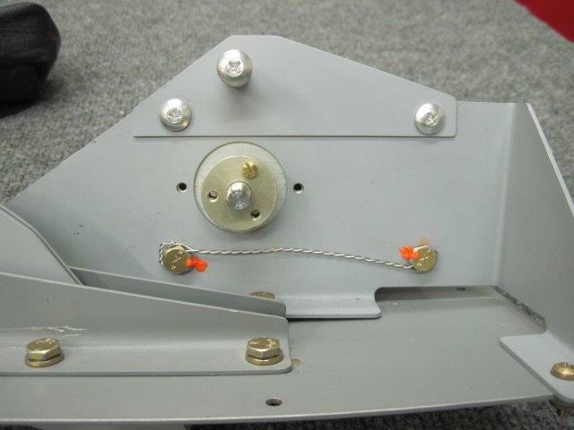

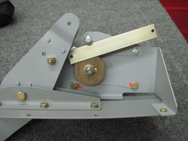

I was always concerned with this design of the pitch servo. I spoke with TT about it 8 years ago and they assured me they had redesigned the force multiplier to remedy this issue. Yours is not the first time this has happened. Just consider yourself extremely fortunate that the arm did not jam the entire elevator operation.
I designed a fail-safe retainer to prevent this from happening should the cable come loose. I also shared this with TT. Here are a few photos of my modification.

Seems like an elegant, easy to implement fail safe mod.
I take it that there may not be an easily identifiable failure mode
where the elevator does jam, but the fact that a stiff control arm could
be flopping about is enough to justify a fail safe mod.
Thanks for sharing!
> the flight home.
> N312F - 1200 hours
> Jim Combs
