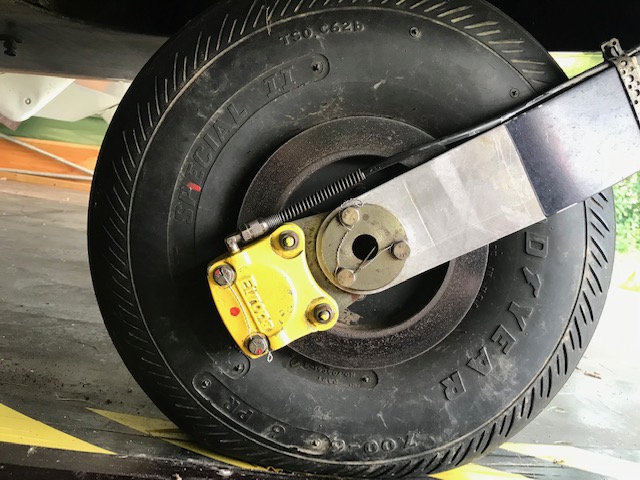

Hi
Need new brake pads for my mono.
Other places to buy these than Europa A?
Gert
OY-GDS, Mono, 914, Woodcomp, 1.000 hrs and still smiling

Not sure about the wire locking on the axle at the 3 o clock point?

Not sure about what .. ?
Question was - where to purchase brakepads .. ?
The wire-locking thing is just fine.

Wired to the loosen side, not the tighten side on 3 o'clock bolt. Good
eye, David.

Thanks Jeff.
RAF training! A minor thing in this case and I don’t think it would cause a problem, but I can still hear my instructors words more than 50 years on.
