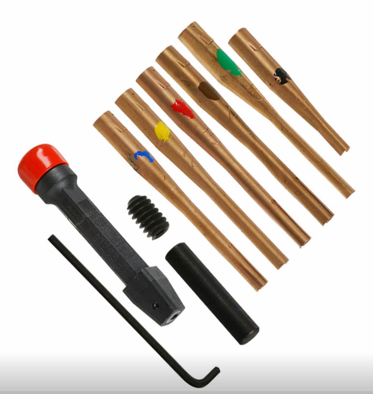

Agreed. Also, consider acquiring one of these
tools:
Specs at:
https://tinyurl.com/y272xsku
You can buy replacement tips from Digikey too
[img]cid:7.1.0.9.0.20190702210312.052b80c8(at)aeroelectric.com.0[/img]
from Digikey at:
https://tinyurl.com/y6f6p9uu
This is the one I carried at Beech for years; works with
a broad range of connectors . . . including D-sub
20 and 22s
 Filesize:  210.45 KB
 Viewed:  14800 Time(s)

When extracting a female pin that
has become detached from its
wire can be pushed out from the
mating side with another female
pin.
The plastic handled tools have two
ends, one tailored for extraction . . .
the other for insertion. They are
identified by the color of the plastic
handle. Here's an updated AEC ShopNotes
that speaks to the details.
https://tinyurl.com/oazfwbc
Unless and until the extraction
tool is properly seated around
the installed pin, the retaining
barbs in the housing remain in
firm control of the pin.

My problem has been the extractor tool I have will not slip over the female pin. I have tried until I am ashamed.
Ron Burnett

First, use one of the extraction tools made out of metal. If your Radio Shack tool is all plastic, it is much harder to get the job done and it might not work at all.
Slide the extraction end of the tool around the pin. That is the more round end. The insertion end is more open, more like a spoon. See http://www.steinair.com/wp-content/uploads/2016/03/SAT-023-CONTACT-INSERTION-REMOVAL-TOOL.pdf
After the tool clicks home, grab the pin itself with tweezers or small needle nose pliers and push the pin out. If the tool is in place and has compressed the barbs, the pin will slide out with minimal force. If the pin doesn't slide out, remove the tool, rotate it 90 degrees or so, and try again.
pin.

I bought two metal pin extraction tools at the local auto parts store, in the aviation department.

The red and white pin tool has an insertion end (red) and an extraction end (white). Sometimes it is difficult to get the white one on a socket. In that case I have had good luck using the insertion tool to do the extraction.
