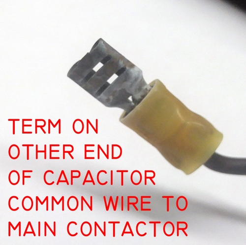

The terminal on the capacitor COMMON lead
carries nearly the same current (~20A) as the
COMPRESSOR side, but it was in good shape.
HOWEVER . . . the other end of the capacitor
COMMON wire attaching to the run contactor
was starting to show stress . . . not in
the crimp but on the Fast-On grips.
[img]cid:.1[/img]
In the case cited above, the terminals were
under-crimped. I'd replaced that same
capacitor in years past but didn't see
a problem with the terminals. But these
were in service for over 10 years
in a pretty unfriendly environment.
This time, ALL the PIDG devices in the
condenser wiring got replaced with a fine,
ratchet-handled mash-tool.
Even tho the catalogs offer a yellow PIDG
for up to 10AWG wire, I think it prudent
NOT to push this technology that hard
in aircraft.
7A or so continuous in blue PIDG Fast-Ons
have a track record of good performance.
If you must push into yellow terminal
territory, make sure they're 'real'
TE Connectivity PIDG and use the
ratchet-handled tool.
