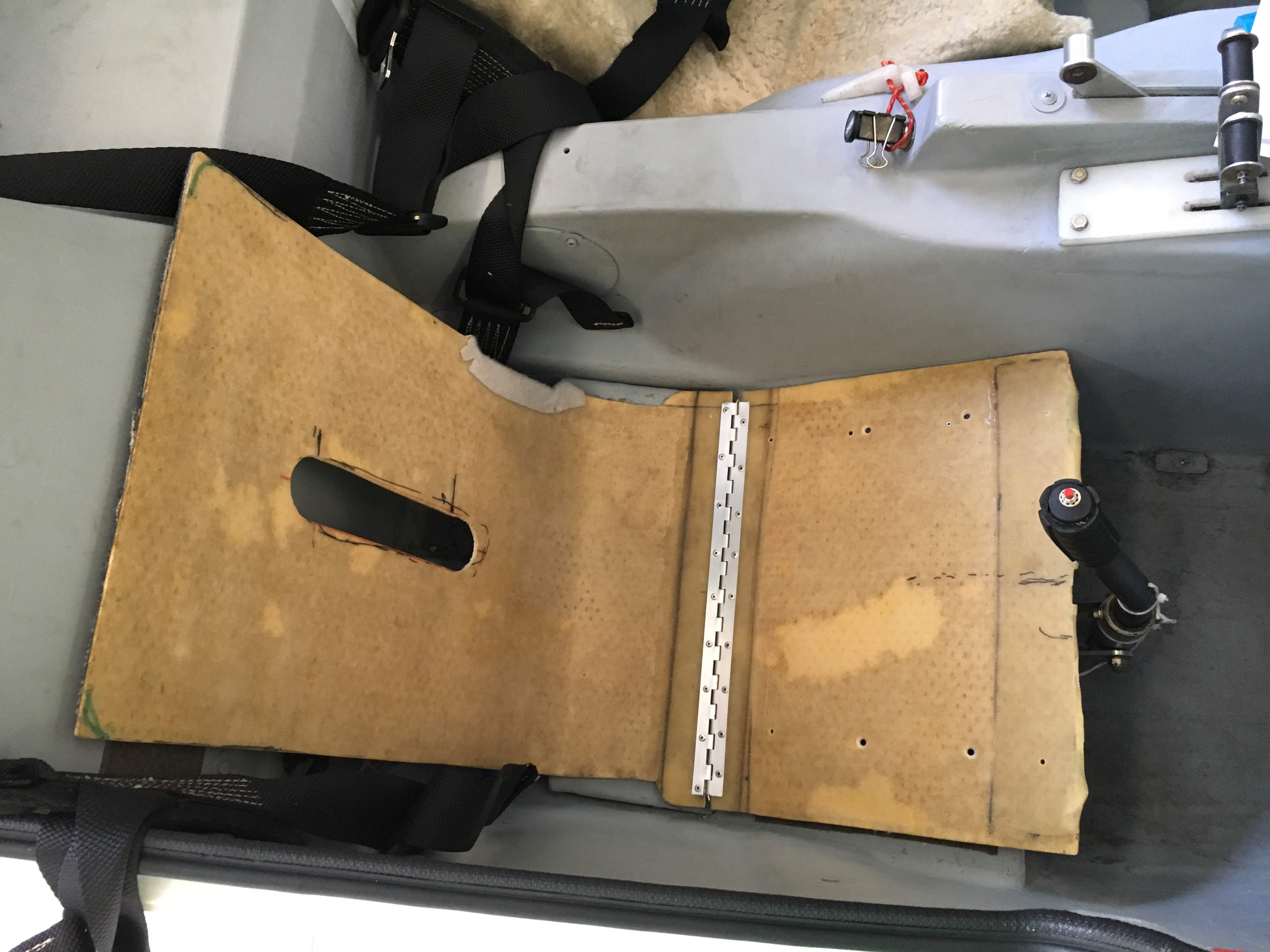

I dont seem to have photos of my seat so I will take some if I remember when I next go to the hangar.  Here's a pic of the right seat.    It has a hinge and removable wedges to adjust the under thigh support.  this photo is
[img]cid:ii_kc2e19hw1[/img]
without the wedges.  My instructor flew from that seat the other day and pronounced it comfortable
[img]cid:ii_kc2e00vf0[/img]
The rudder pedals are in the standard location.
My principle with the aircraft was to make it as light as possible.
The seat I made for myself from composite/coremat. It is about 1/4" thick.   It is designed to support my weight evenly from shoulder blades through to back of thigh so that almost no padding is required.  Today I fly with just a sheepskin - no foam.  I am aware of the issue of hard landing and compression but  I  considered that the lack of padding would be mitigated by distributing my weight over a wider area.
There is about an inch from my headphones to the plexi
As it happened when I flew from Colombia to USA I flew every day for two weeks up to 5 hours a day and was never uncomfortable.

PostPosted: Tue Jun 30, 2020 9:11 pm    Post subject: Re: 5 point harness Reply with quote
Thanks for clarification, Daniell - interesting! I'm not that tall with 1,82 metres but cockpit space is the only thing I'm missing a bit in the Europa. However I have to add, that I'm wearing a parachute and without it I'd have 2-3 Inches more legroom. What also might contribute to comfort in your plane, especially on longer flights, is perhaps the less upright position of the upper body. I can see on the photos, that you also have cropped control sticks installed, which provide more space to the front edge of the seat.
