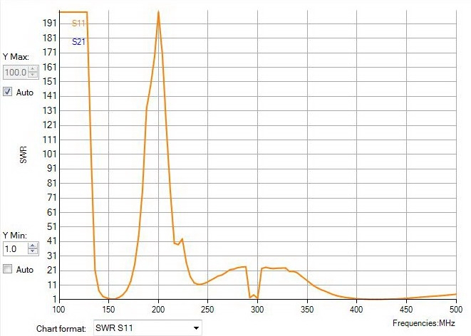

By the way, I was curious about how
well those little VHF/UHF 'rubber duck'
antennas worked on contemporary VHF/UHF
hand-helds. Screwed an antenna off my EMS
talkie to the VNA and ran a 100 to 500 MHz scan
which yielded the following plot:
[img]cid:7.1.0.9.0.20190717122807.06247668(at)aeroelectric.com.0[/img]
Sho 'nuf . . . the little critter has SWR
'dips' that span the frequencies of interest.
Pretty cool . . .
