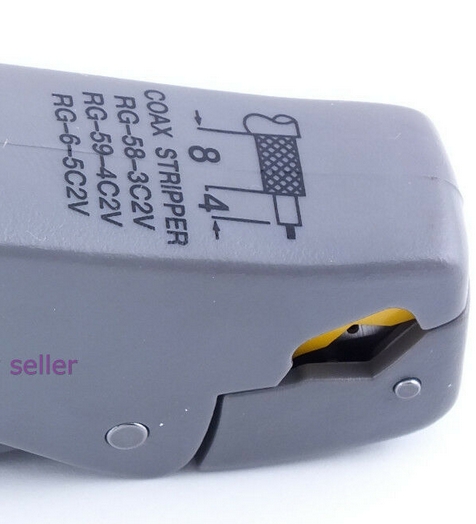

This is a two blade stripper . . .
recommend a 3-blad stripper that
offers removal of jacket, shield
AND inner insulation
[img]cid:7.1.0.9.0.20190823152048.02011990(at)aeroelectric.com.0[/img]
Here's one example of several
https://tinyurl.com/y33rwjzv
That crimp tool is generic and offered by
dozens of sellers with a wide range
of prices. Price is not generally
indicative of quality . . .but I think
I've only seen one unsatisfactory batch
of these critters off eBay in the past
20 years.
