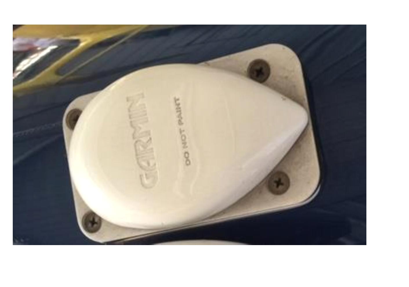

I would like to remove the GPS antenna on my airplane. The antenna is shown in the attached picture.
The antenna appears to be strongly bound to an aluminum support plate. There are no screws between the bottom of the antenna and the plate that would not be visible in the picture.
I removed the 4 screws located at the corners of the plate, hoping that the antenna/support plate assembly would come off the underneath support saddle as a unit, but they are not coming off. The plate is also firmly bound to the saddle.
Any suggestions on how to remove this antenna? My preference would be to disconnect the antenna from the plate, but also disconnecting the assembly antenna/plate from the saddle would be acceptable, as long as the saddle under the plate stays in place on the airplane and all the components are not damaged and can be re-used.

The pic makes it look like it's on fabric;  what's it attached to? If
it's on the outer skin, there's likely sealant between the puck & the
plate, and between the plate and the skin. My bet is that there are
countersunk screws coming up through the bottom of the plate into the
puck. I'd try a plastic blade gently around the edges of the plate-skin
interface, to see if it'll peel up.

The antenna is attached to the turtle deck that is made of aluminum plate and is covered with fabric, as you pointed out. A saddle, that does not appear to be made of metal, is attached to the turtle deck and provides a flat surface for the installation of a metal plate. This plate is attached with 4 screws with 4 screws and some sort of glue to the saddle. The antenna seems to be attached just with glue to the plate, but it is possible that there are also short screws (that don't go past the saddle inside the turtle) deck, connecting the antenna to the metal plate. As stated in my initial post, I would like to leave the saddle on the airplane, because I intend to install a different GPS antenna.
