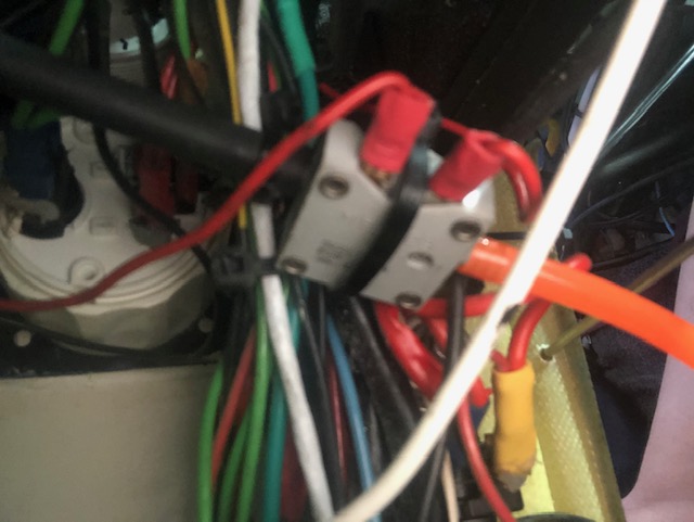

Can anyone help with the pneumatic stall sensor connections ? If I suck on the orange hose, the buzzer sounds. I presume this end is connected to the hose that runs to the leading edge and that the other side is connected to the static system. Is that correct ?

I think I have the answer to this.
It's an MPL 503 pressure switch
https://www.aircraftspruce.com/catalog/inpages/mpl500series-ps.php
The V-vacuum side connects to the port in the leading edge and the pressure side to the static system
It tests correctly on the ground with slight suction on the port
