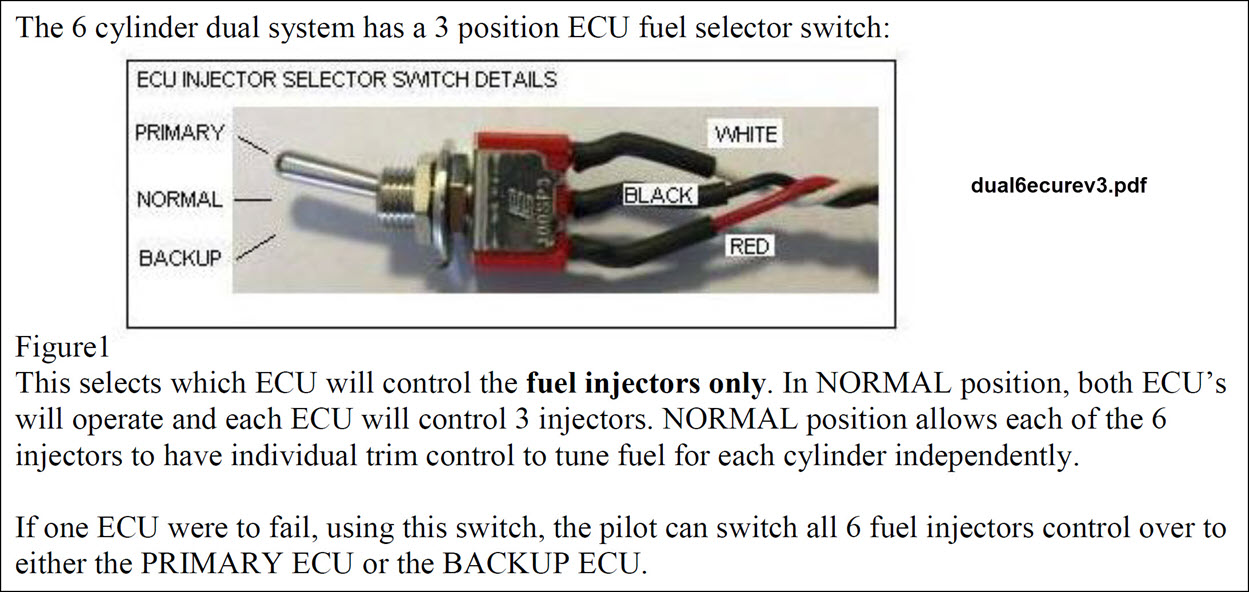

You are using SDS dual ECU for six cylinder with fuel trim. I know the dual four cylinder wiring because I have the harness and relays. SDS does not show full schematic details in their install manuals. It looks to me as though the Normal injector switch position is relays not energized. Suppose the black wire to the common terminal of the SPDT switch was broken; engine would run in all three switch positions and pass preflight. Ref attached snip from "dual6ecurev3.pdf".
I'm not sure that I'm following correctly. That switch determines whether the injectors are running off of one or the other ECU or both (each taking three injectors). If you were on both and that wire were broken I'm not sure why the engine would continue to run normally.
Hi Randy,
I don't have the relays and harness in hand to 100% verify but I imagine:
    The Normal injector switch position is relays not energized, three injectors on each ECU because an ECU can't individually drive six injectors so cylinder trim wouldn't work.
    The Primary position energizes a relay to take three injectors off the backup ECU and put them on the primary ECU, injectors paralleled in pairs.
    The Backup position energizes a relay to take three injectors off the primary ECU and put them on the backup ECU, injectors paralleled in pairs.
There is also a Mixture Knob Relay. Perhaps that disables cylinder trim.
