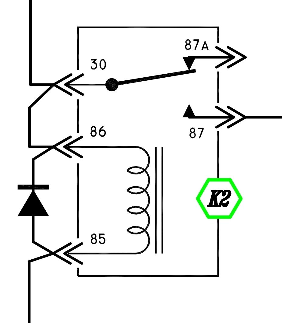

Question... what is the part number of this relay shown in Z-02 and Z-07?

Search internet for "40 amp automotive relay".
You can buy relays at auto parts stores.
Some relays come with a built-in arc suppression diode,
but they are not easy to find.
So, install a diode across the relay coil with the banded end towards positive.

I was expecting a 40 A relay to be labeled S8009-1, that's what led me to call it Mystery Relay. Z-02, which is preliminary, implies the relay is able to carry enough current to blow a MANL 30; I wasn't sure a 40 A relay would do that.
I gather a 40 A automotive relay is TE connectivity 1432791-1 or similar.

The current rating of a relay has been determined by the manufacturer to
provide a useful service life. If a relay is operated above its rating, it will not
immediately self destruct, but its life will be shortened. If a relay is already
energized when a short circuit occurs, a relay could carry 2 or 3 times its rated
current for a short time, long enough for an ANL fuse to blow.
