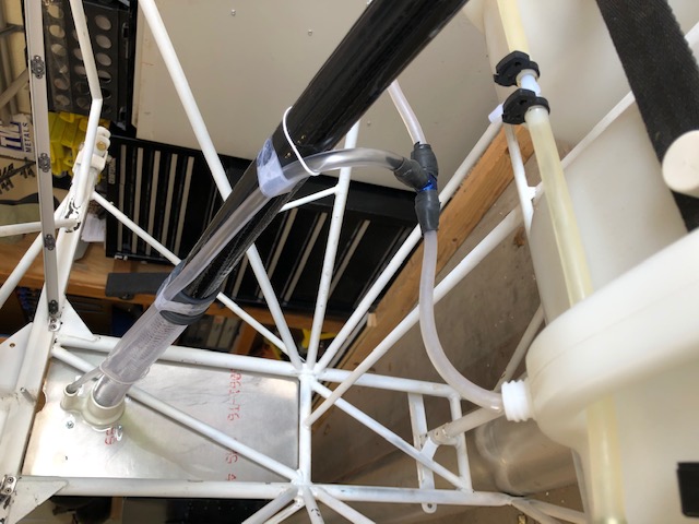

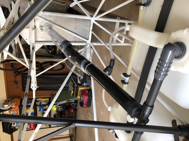

Hoping the group.can help me with suggestions on how to properly vent the tanks. I plan to T them together & connect to the filler cap.

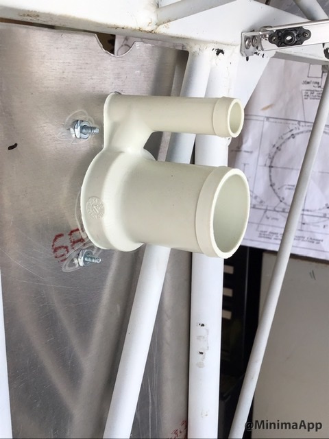

The filler cap.

Richard,
Both fittings will be reduced down & joined to a “T” fitting.
I was uncertain of the vent cap / termination methods.
suggestions welcome.

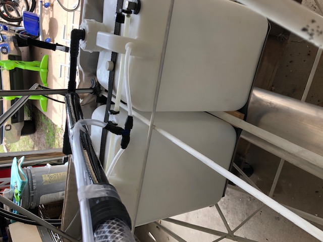

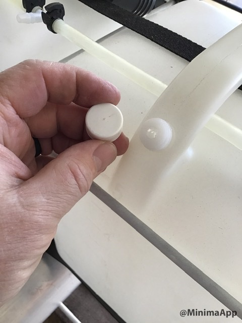

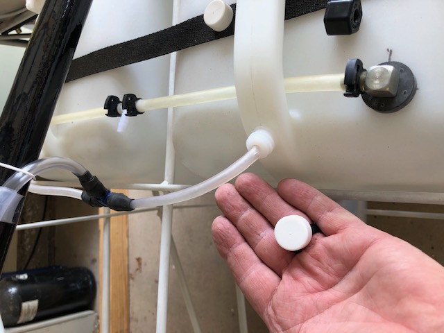

Rick,
Please see attached, suggestions are appreciated.!!
The tubing is mock up only...
my concern is attachment to the tank bung - for proper ventilation/evaporation concerns.

JBM has fuel resistant tank grommets

I am only guessing here but I suspect your vent location is in a low pressure area. You may want to do some additional research or contact Kolb. Surely would not want to vent tanks to a low pressure area.

Ducati SS brings up a good point, and it's not just the low pressure - every time the prop passes the aft end of the fuselage you are going to get a pressure pulse. Have no guess as to what that may or may not do.

I was told and have followed the practice on several aircraft, to run the open end of the vent line to a point that is lower than the bottom of the tank(s). I run mine down along side the tanks to a point below the pan that the tanks sit on. The theory being that if you are unfortunate enough to wind up inverted on the ground, the fuel will not run out through the vent line.
