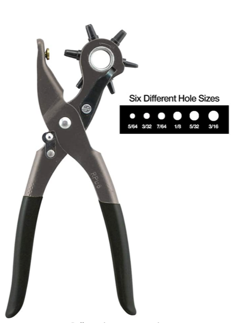

PostPosted: Sat Jun 20, 2020 8:50 am    Post subject: Stewart Warner fuel tank sender Reply with quote
I used these gaskets
https://www.amazon.com/dp/B0075EBPKS
Viton Fluoroelastomer Flange Gasket, Ring, Black, Fits Class 150 Flange, 1/8" Thick, 1" Pipe Size, 1-5/16" ID, 2-5/8" OD (Pack of 1)
and just punched holes in them with a leather punch tool like this:
