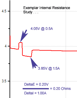

--> AeroElectric-List message posted by: Dick Tasker <dick(at)thetaskerfamily.com>
Oops. For your example, the delta current is actually 2.444-1.235=1.209A. So the R=0.015/1.209=12.4 milliohms.
You forgot to subtract the first reading. Other than the simple math error (something I do all the time...) the rest of the explanation is spot on.
Dick Tasker
Good catch! Thank you sir.

Just for grins, I conducted a quick
delta-I resistance check on one of the
cells last night. Snapshot attached.
The CBA IV software has a 'dynamic'
current mode that allows you to change the
load current while the test is running.
Pretty cool . . .
