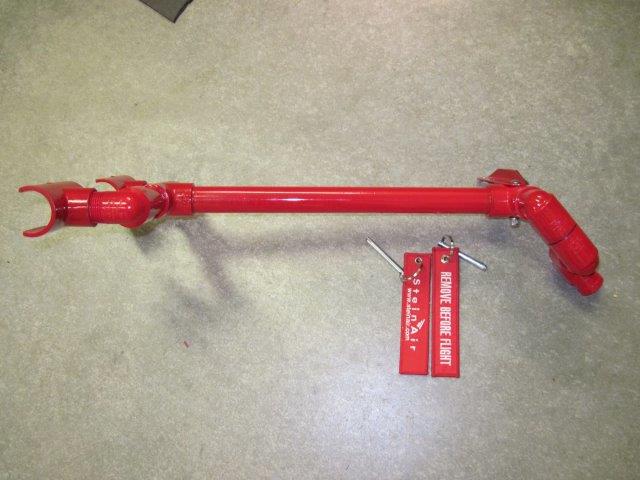

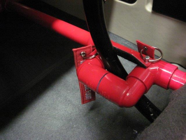

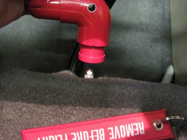

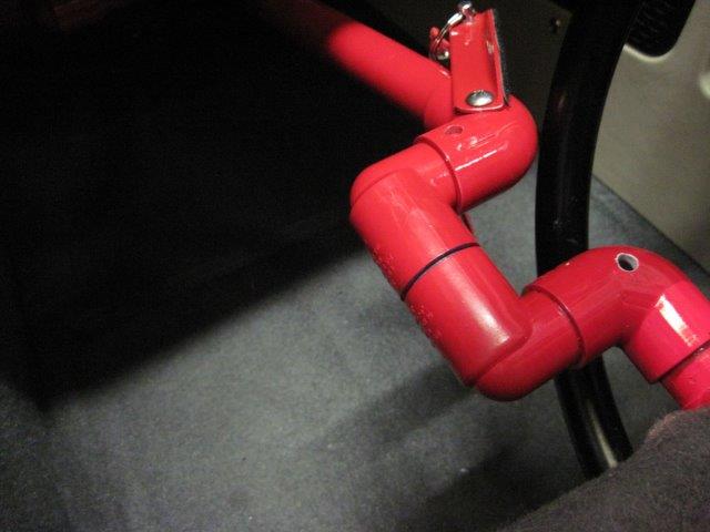

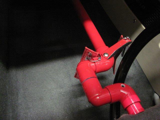

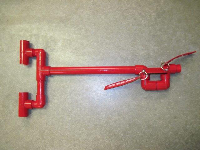

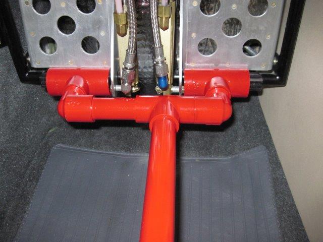

I built this gust lock out of PVC for less than $20. I have been using this since 2012 and over 1000 hours and never had a failure in all kinds of wind etc. It holds the rudder, elevator and ailerons with just a slight amount of flex in the pvc. The hinge is designed so that it locks in over-center thus putting pressure on the rudder pedals. The rear end is held in place by a number 8 screw with a dome nut the fits into the end of the gust lock. It can't move out of place.
Sorry in advance for the size of these photos
