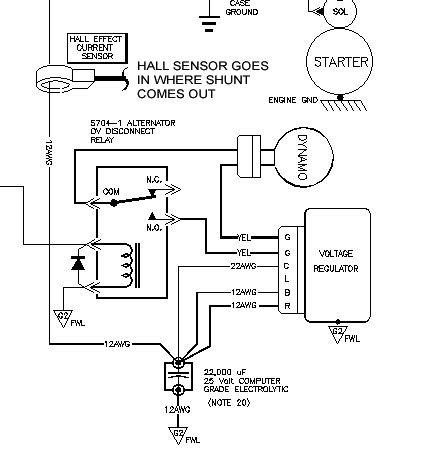

I was wondering what locations might be possible for installing a hall effect current sensor on a Z-16 system. Will one or both yellow wires work?? Or, am I limited to the battery lead?
Chris
Just Highlander
the yellow wires carry AC current at values
related to but different from the DC output
of the rectifier regulator. If you're wishing to
incorporate the legacy DC hall sensor common to
virtually all EFIS systems, the sensor goes in
the BAT leads of the rectifier regulator.
Chris
Just Highlander
See attached
