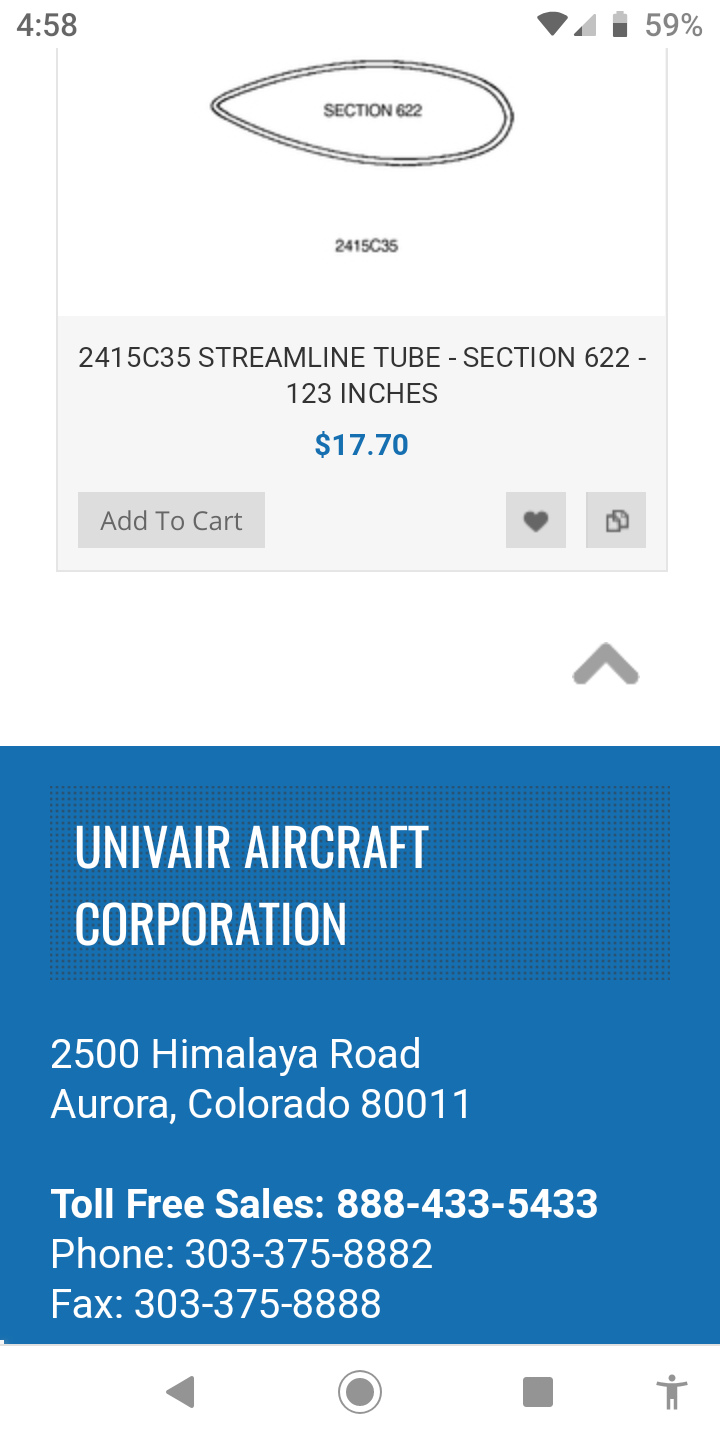

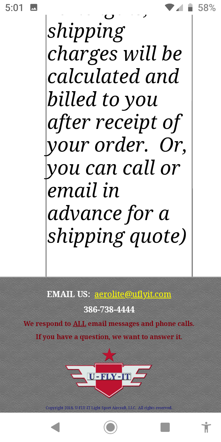

I found these if anyone is still looking.
