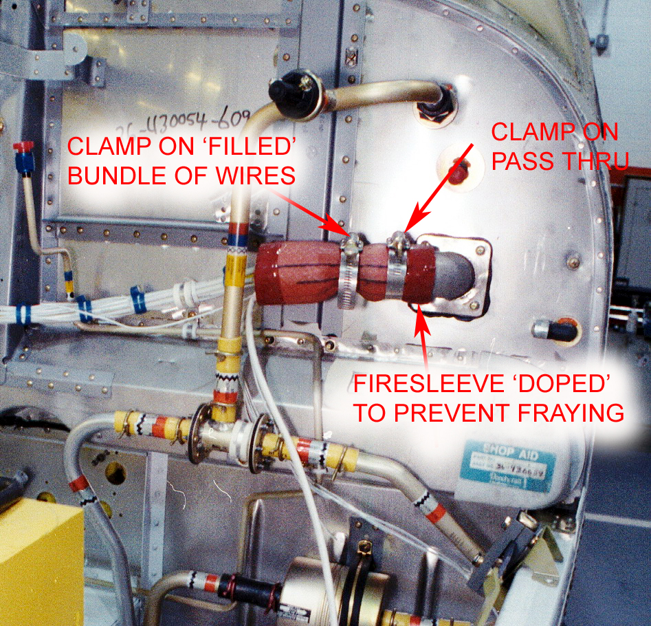

More that once, I've seen a grey-beard at Raytheon-
Beech give someone the 'evil eye' for suggesting
any sort of uckem-yucky for use on production
lines. I won't say that tubes of squeeze-out-stuff
were never used on the finished product but it was
rare.
Pass-thrus on the 30 series airplanes were configured
as shown in attached. A piece of firesleeve was first
'doped' on the ends to prevent fraying (yup, that
was a brush-on uckem-yucky). It was clamped hard
onto the feedthru tube. If the wires passing thru
did not 'fill' the voids, pieces of firesleeve
'tape' were wrapped around and thru the strands and
secured with a string tie before a second stainless
clamp would bring the matrix of firesleeve into
close contact with wires.
This closure method was no doubt 'proofed' by
Puff-the-Magic-Dragon who resided in Jack Thurman's
house of horrors. No ooze, goop, or wiping rags yet
EASY to disassemble for maintenance or addition
of new wires.

I think Bob is saying that the firesleeve/hose clamp method (which I also referenced) was tested in a production aircraft facility (Raytheon-Beech) using a blowtorch type device, to FAA qualification required limits, and I suspect that Jack Thurman ran the testing division.
