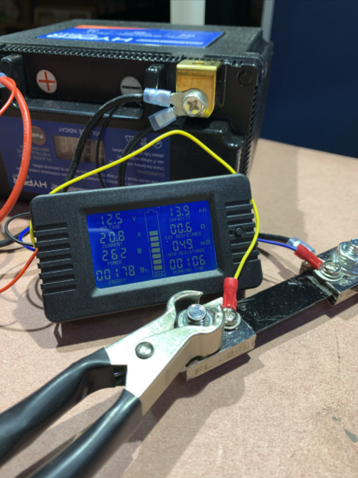

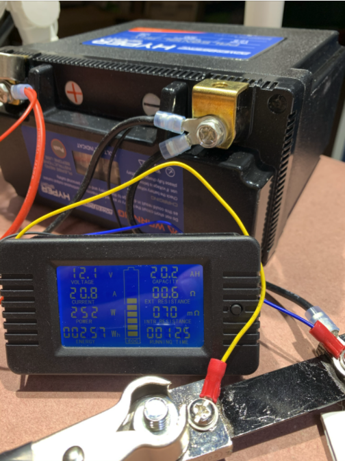

TLDR; The PAL50N18L LiFePO4 (Hypersport) is rated at 128 W/Hr. I tested at currents between 12.5 and 20 amps and found the capacity was at least 260 W/Hr. At well under $200 is this a fantastic bargain in batteries, or have I missed something?
I’m building a Marquart Charger with an electrically dependent engine using SDS EFII. I settled on a single alternator / 2 battery system. I forget Bob’s schematic # but it’s one of them. My objective is to have a comfortable amount of flying time in the event of an alternator failure. To compensate for a failure of one battery or the other, each of the batteries needs to be able to run the engine for a reasonable amount of time. I believe that with a single boost pump operating I will have a current consumption of a little under 10 amps. The Marquart Charge is an open cockpit biplane.
Anyway, I took a plunge and bought a Power-Sonic PAL50N18L LiFePO4. Yesterday I started testing it, and I want to share the results for 2 reasons. 1) Help out somebody looking for a battery like this. 2) Double check my experimental results to make sure they are correct.
For my test I bought a cheap battery monitor from Amazon and used a Lectron 10A hobby charger. The battery monitor uses a 75mv - 100A shunt. The battery monitor’s current readings  were verified by the voltage drop across the shunt, my multimeter hooked up in series at less than 10A, and also the Lectron charger’s AH numbers. If the battery monitor says that you took out 20.3 Ah the Lectron will put very close to 20.3 Ah back in. So even though I’m using cheap stuff, I think it’s fairly accurate.
I loaded the battery with a 400W inverter running a work light and a box fan. Pictures are attached.

Double the rated total energy sounds like a mislabeled battery. Wink Supporting that would be the 50% greater weight than spec. The PS datasheet for that model says that the 'cutoff' point should be 12.8V, and their discharge graph shows a 7.5A load discharging to ~12.8V at around 50 minutes. That '128WH' number means that even though the model number makes you 'feel' like it's an 18 AH battery (using typical SLA nomenclature), it's really a 10AH battery. If I were electrically dependent, I'd treat that number as the absolute best case, and de-rate by close to 50% to account for variations in quality, load, aging factors, etc.
EFI, including the fuel pump, *might* consume as low as 10 amps, but I'd want to verify that in actual operation; not by 'faith'. The fuel pump alone will consume somewhere between 4.5 & 8 amps, depending on model. To the engine electrical consumption, you need to add whatever additional loads needed in the plane.

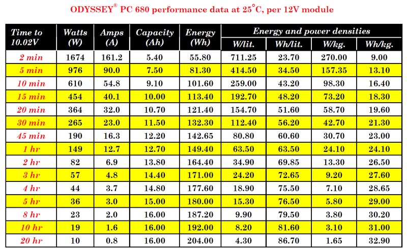

Note that the PC680 is spec'd to deliver 132 WH
for 30 minutes under a 23A load. LiFePO4 with
similar capacity will be in that ballpark.
Note too that as the test current goes DOWN,
the delivered energy goes UP. This is because
less energy is lost to the battery's INTERNAL
RESISTANCE at lighter loads.

Your test results suggest a review of test
methodology and instrument capability. I suggest
that the PowerSonic spec sheet is pretty much
gospel. Your bench tests should produce results
pretty close to specs.

I have a high degree of confidence that my measurements were accurate. It's not hard to put a known load on a battery, measure the current, and run a stop watch. With an inexpensive battery monitor it's child's play. Then charge with a good quality charger and see what goes back in. They matched (minus small charging loss). I also had a dialog with the distributor who spoke to Power Sonic people.
An inverter with incandescent bulbs of varying sizes is the best way i found generate predictable loads.
There is obviously no guarantee that future releases of this product would match those measurements. But for a while they were selling a fantastic bargain.
I have tested two other PowerSonic Hypersport batteries since. All exceed spec by a fair margin, but none by so much. I even ran a few in a refrigerator. Don't ask me why.
