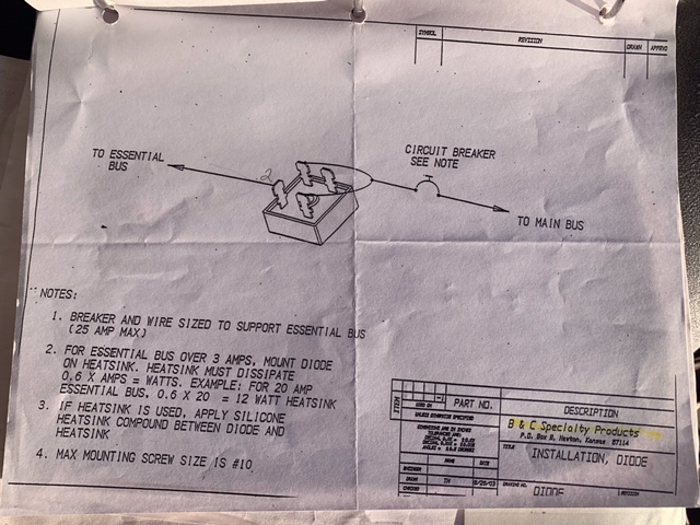

The builder is getting up there in age and it was built 12 years ago but he told me he chose this design so if there was an alternator failure it would transfer automatically. He added that he always thought he should remove the one way diode. The diode diagram is attached. I did remove the diode by disconnecting it but the Stby Alternator regulator and fuse blew.

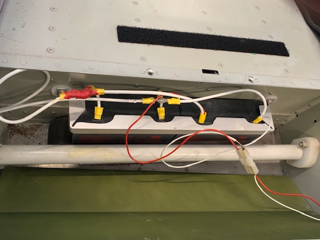

Regarding the two batteries; number 1 is an Odyssey 925 and number two are the wheel chair batteries wired maybe in parallel; picture included. I am not sure these qualify for an alternator all their own? I’m not sure which way to turn.
