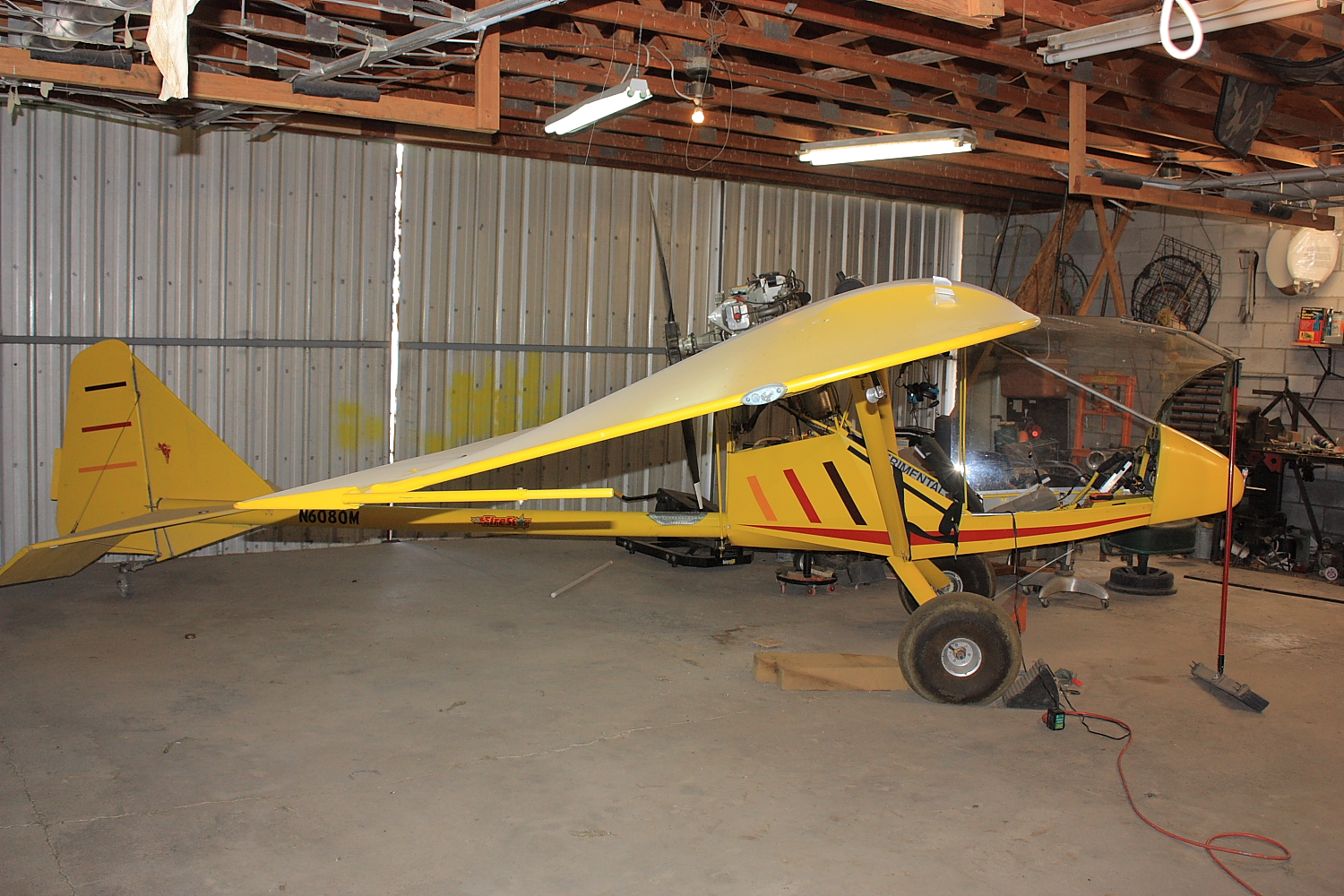

On Mon, Apr 5, 2021 at 1:44 PM <1957grnchev(at)bluemarble.net (1957grnchev(at)bluemarble.net)> wrote:
--> Kolb-List message posted by: <1957grnchev(at)bluemarble.net (1957grnchev(at)bluemarble.net)>
Hi Larry!
When you are at cruise is the wing 6-8° positive?  That would put the
engine thrust at 0.  What's the stab angle, as compared to your wing/engine
measurements.  I'd guess it's less than the engine, to produce some tail
down to balance the engine push over effects.

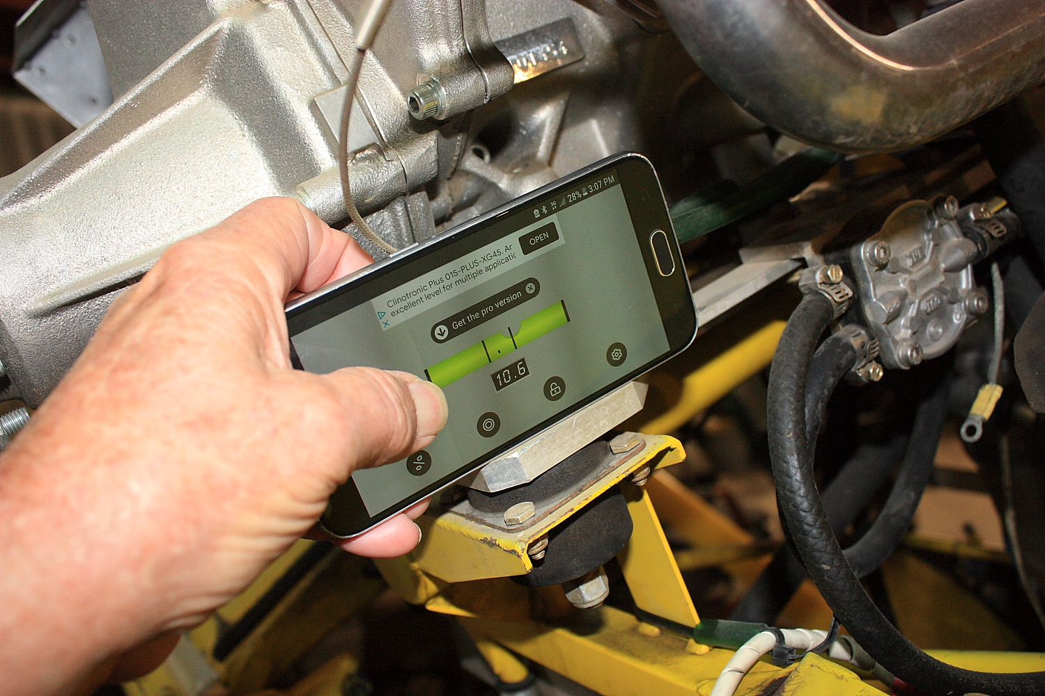

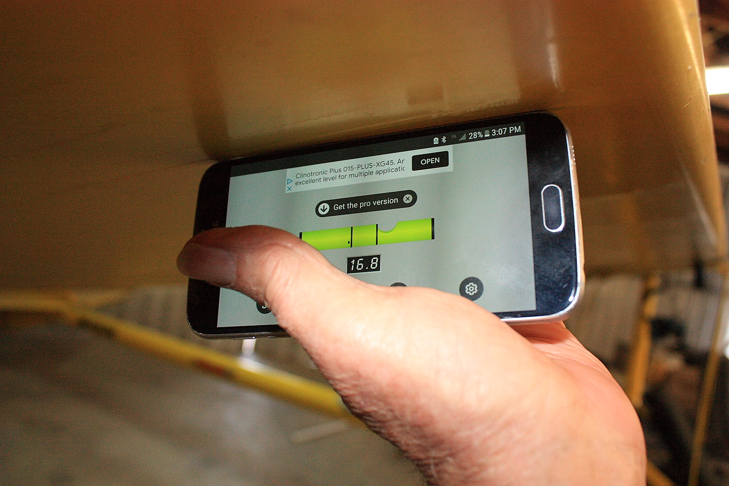

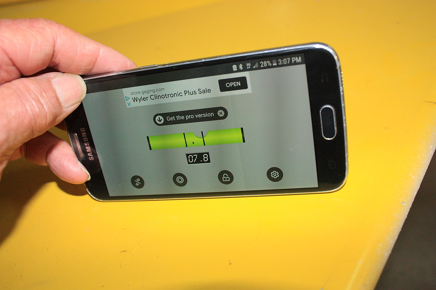

Since the plane is just out in the hangar, I decided to quit fooling around and just use my ?smart phone? to do the job for me. Since I manage to fool myself oftener than I would like.
Larry
