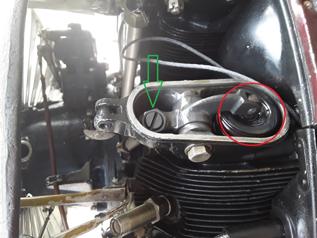

Good evening all-
A conundrum for you Housai engine experts; I need some advice to go fwd.
Doing the compression check today, I hit a weird wall.
With a partner I was checking cylinders starting with #1 at top, going CW when viewed from cockpit.
All #'s were good (avg 75/80 psi), until I got the last cylinder, #2.  We got 0 psi on the pressure gauge.
Checking the pressure tester/gauges/fittings/hose, all are fine and perfectly functional.
So we double checked the previous cylinder, which had just 10 min prior tested at 74/80 psi.... now it also
showed 0/80 psi. ??
No obvious air leaks from oil breather, carburetor, or exhaust stack; no oil evident at bases of the cylinders;
the exhaust and intake stacks are good condition.  I had flown the plane earlier in the day w/o any negative
indications.
Pulled the valve covers off to find the rocker arms, springs, etc in great condition, doing their job when we
slowly turned the prop thru by hand.
Stuck valves?
We tried the "rope trick" to slip a nylon cord into the cylinder thru the open sparkplug hole, then gently run
the piston up to TDC to try to reseat the possibly stuck-open valves.  As yet, no help.
Fishing for advice & thoughts... what are we missing?
I've never seen a 0/80 psi reading... a bad piston ring or bad valve, should have SOME psi indication 30~60psi.
Thoughts?  Pointers?
Thanks---
Justin Drafts
N280NC

PostPosted: Wed Apr 28, 2021 8:14 pm    Post subject: Housai engine question: compression check Reply with quote
Clogged secondary gauge. If you collider off the gauge exist and open the valve between the two gauges, do you get 80/80? If not the second gauge is hosed.

PostPosted: Thu Apr 29, 2021 1:47 am    Post subject: Housai engine question: compression check Reply with quote
Hi Justin,
I can’t speak for the Housai, but I had the identical thing on my M-14P.
Check your valve clearances. I found mine were a little tight. After adjustment, problem solved.
Failing that, give the top of the valves a whack with a plastic faced hammer to unseat them a few times. This will dislodge any debris that might be holding the valve slightly open.
I hope this helps.

PostPosted: Thu Apr 29, 2021 3:47 am    Post subject: Housai engine question: compression check Reply with quote
When you had the valve covers off on #2, did you check the valve lash at TDC? Should be between .25 and .35 mm or .010 - .014.

dsavarese0812(at)bellsout
PostPosted: Thu Apr 29, 2021 4:04 am    Post subject: Housai engine question: compression check Reply with quote
Also check the the air injector to make sure it is fully closed.  It
too
has a very small valve inside of it about the size of a pencil eraser.
If the little valve spring is broken or the valve remains open, it will
of course affect the compression test.

bwade154(at)yahoo.com
PostPosted: Thu Apr 29, 2021 5:48 am    Post subject: Housai engine question: compression check Reply with quote
Justin on your next compression test start at 1 go to 3, 5, 7, 9, 2, 4, 6, 8, the reason being you only need to move the prop a few deg to be TDC on compression stroke at the next cylinder. Also what kind of air flow do you have with your tester? Valves should be quite evident with the sound of air coming out the exhaust or carb, you don't want to hear it feel it at the breather that's BAD. Maybe take the tester out of the equation and inject air into the cylinder to find the direction of the leak as 0/80 is a very good flow?
So we double checked the previous cylinder, which had just 10 min prior tested at 74/80 psi... now it also
showed 0/80 psi. ??
indications.
Stuck valves?
Thoughts?  Pointers?
too
Dennis

Thanks for all the quick replies folks... going to the hangar in a bit for round 2.
I did try the rubber mallet approach to try and wallop the valves into obedience, no luck but might need to try again.
Mm, I've always had success feeling for the tell-tale puff of air out the open sparkplug hole to indicate the piston was starting it's way up on compression stroke, then finalize the tdc sweet spot (slight prop rotation) under ~40psi.
Once there,  raise press to 80psi...
Has always worked well w/ consistent #'s, until yesterday.
With the 0/80 psi reading, esp on a cylinder I'd just checked at 74/80 psi, I lean to Dennis' idea of a stuck-open air input line. ?
But, not sure... I confess I'm a novice on in depth engine issues.
Justin

YES I'm perpetually grateful for all the expert advice in the group!One day I might advance past Nanchang novice status...
Oh I wish it was my test equipment that had pooped the bed, but it read great for 8 out of 9 cylinders, even going back to randomly check #7 again after #2 and #3 showed that suspicious 0/80 psi reading (even tho 10 min prior, #3 showed a very good 74/80 psi). In a failure of that magnitude, of course the 1st and wisest resort is to question the test equipment, but this time I'm confident, sigh, it's working well.
Will go tap the valves again, and look into the air inlet valves.
Thankfully at first insp, rocker arms, springs, etc still looked factory new.
Good info on the check sequence, thanks all for insights.
Pls keep them coming, and will pass on any new info or solutions I find today...
Justin
Stuck valves?

Try this. Bring the dead cylinder up to TDC. Then without using the compression tester, connect the compressor line directly to the plug adapter you use to do the compression test. If you can adjust the output pressure on the compressor, start at zero and slowly increase the pressure while listening carefully for any air leaks at the dead cylinder. As you increase the pressure from the compressor, if there is an air leak from an exhaust valve, you’ll hear it clearly out of the exhaust stack. If it’s an intake valve, listen at the throat of the carburetor. If it’s an air injector you’ll hear I at the injector’s banjo fitting. Dennis
Justin

Try hitting the rocker arms with the rubber mallet when you have air pressure on the cylinder. It should have a pretty loud “pop” when you strike the rocker arm.
Don’t forget to check the valve lash. This is very important. Especially if a valve is tight.

Sorry but pls remind me on best practice to check valve lash?

Ya, I end up rotating (correct direction!) the prop thru a bit more to find each successive cylinder's TDC this way... admittedly it does take longer, but I'm on vacation, Smile
Will take a crack at the small air intake valves asap.. thankfully I have a battered old spare parts engine to practice on.

I can’t ever remember doing a leakdown test in anything but the firing order.  One cylinder follows the last after 40 Deg. of rotation – piece of cake.  However I note you started from the top and rotated CW as viewed from the cockpit.  But it seems to my addled old brain that all British and the rest of the worlds engines (other than the US) turn the other way.

YES I'm perpetually grateful for all the expert advice in the group! One day I might advance past Nanchang novice status...

Ok helpful gents and engine experts-
A fruitful sunny day spent (at) hangar with the suspect cylinders.
Checked the small starting air valve: definitely in good working order and closing as appropriate.
Pulling off rocker covers and watching the rocker arm and valve springs, I see there is
no gap at TDC between the rocker arm and top of the spring /stem for cylinders #2 and #3.
Just so I'm understanding valve lash / clearance correctly:
-  the 0.010-0.014" clearance mentioned is supposed to be here at the red circle in the
attached pic, correct?  (While the stem is at its highest point of travel/valve fully seated/TDC...)
-adjusting this clearance/lash requires turning the large adjustment screw at the green arrow, correct?
Based on the air I hear escaping the exhaust stack, I suspect the exhaust valves are sticking or
otherwise remaining open.
Not sure how I went from great compression #'s last year to 0/80 psi this year, but very little surprises
me in maintenance anymore.
Thoughts gents?
Thanks-   Justin
