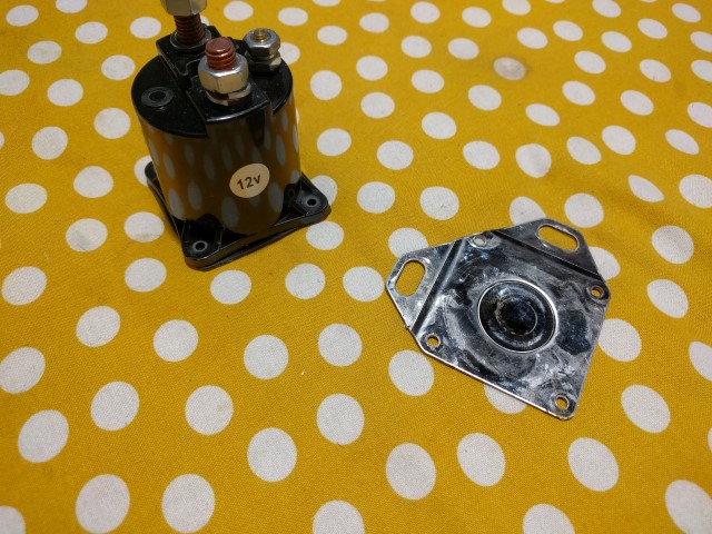

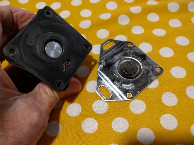

My neighbor sourced a starter solenoid online (I forget if it was ebay or Amazon) and it worked for about 2 flights before going intermittent. When he disassembled it, he saw this method of grounding the coil wire. I'm not immune to using 'generic' parts, but this does show that it makes sense to verify quality on parts with unknown pedigree.

That kind of thing makes me wonder if and how, cheap low-quality look-alikes might infiltrate legitimate supply chains.
Makes me kinda nervous but also makes me feel a little better about spending 2x or 3x as much for a "genuine Ford (or whatever manufacturer)" part.
Caveat Emptor and you get what you pay for (how do you say that in Latin?Wink
-Jeff

Yup . . .
There are many sources for form-fit-function
contactors that would appear to fill the need.
Fortunately, most are probably of good value
and will perform well. It is not DIFFICULT
to avoid pot-holes in design such as you've
discovered. But design isn't always the
problem.
Check out the illustrations at:
http://www.aeroelectric.com/Pictures/Contactors/70%20Series%20Contactors/
In particular, this image at
[url=http://www.aeroelectric.com/Pictures/Contactors/70%20Series%20Contactors/70%20Series%20Failure%20(circa%202000)/TearDown_10.jpg] http://www.aeroelectric.com/Pictures/Contactors/70%20Series%20Contactors/70%20Series%20Failure%20(circa%202000)/TearDown_10.jpg[/url]
This contactor failed for lack of due diligence
in assembly . . . which can happen to anybody.
All of the products illustrated in this series
of pictures were nominally well suited to task
by manufacturers with good track records.
